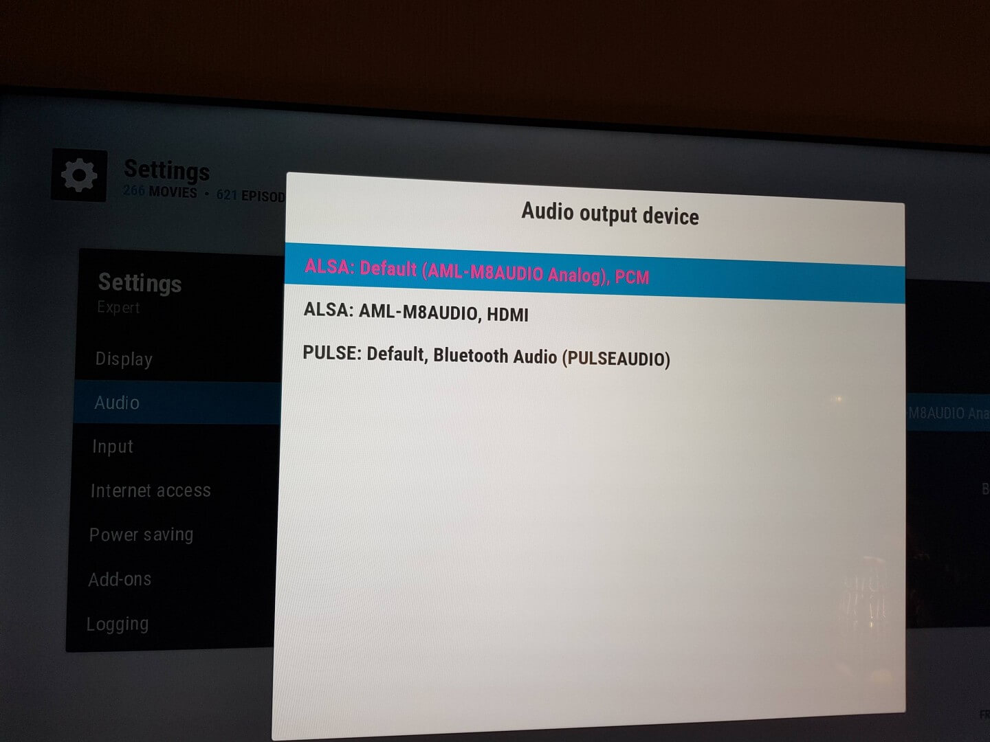

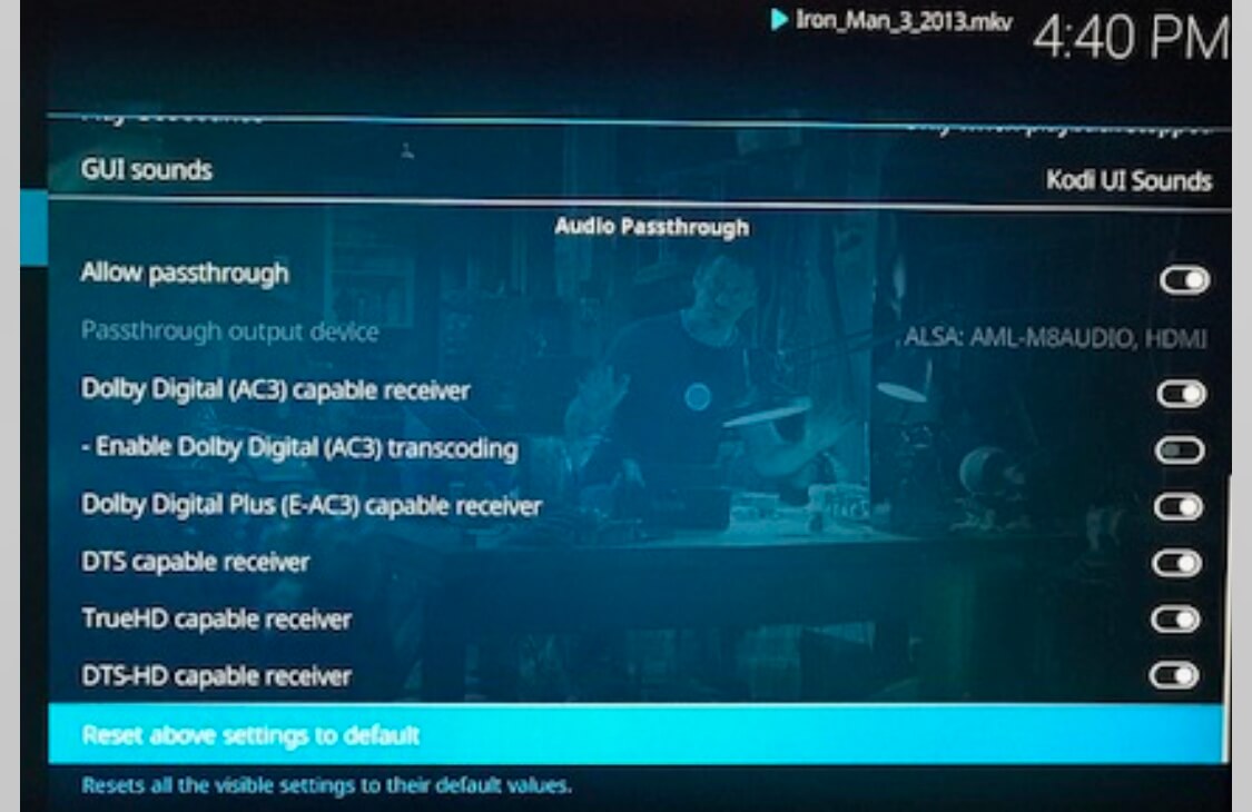

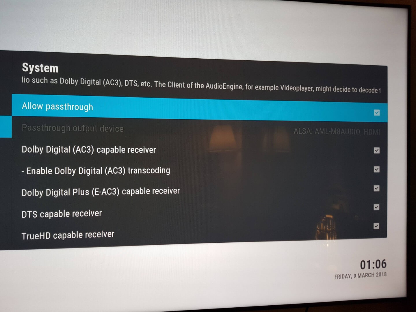

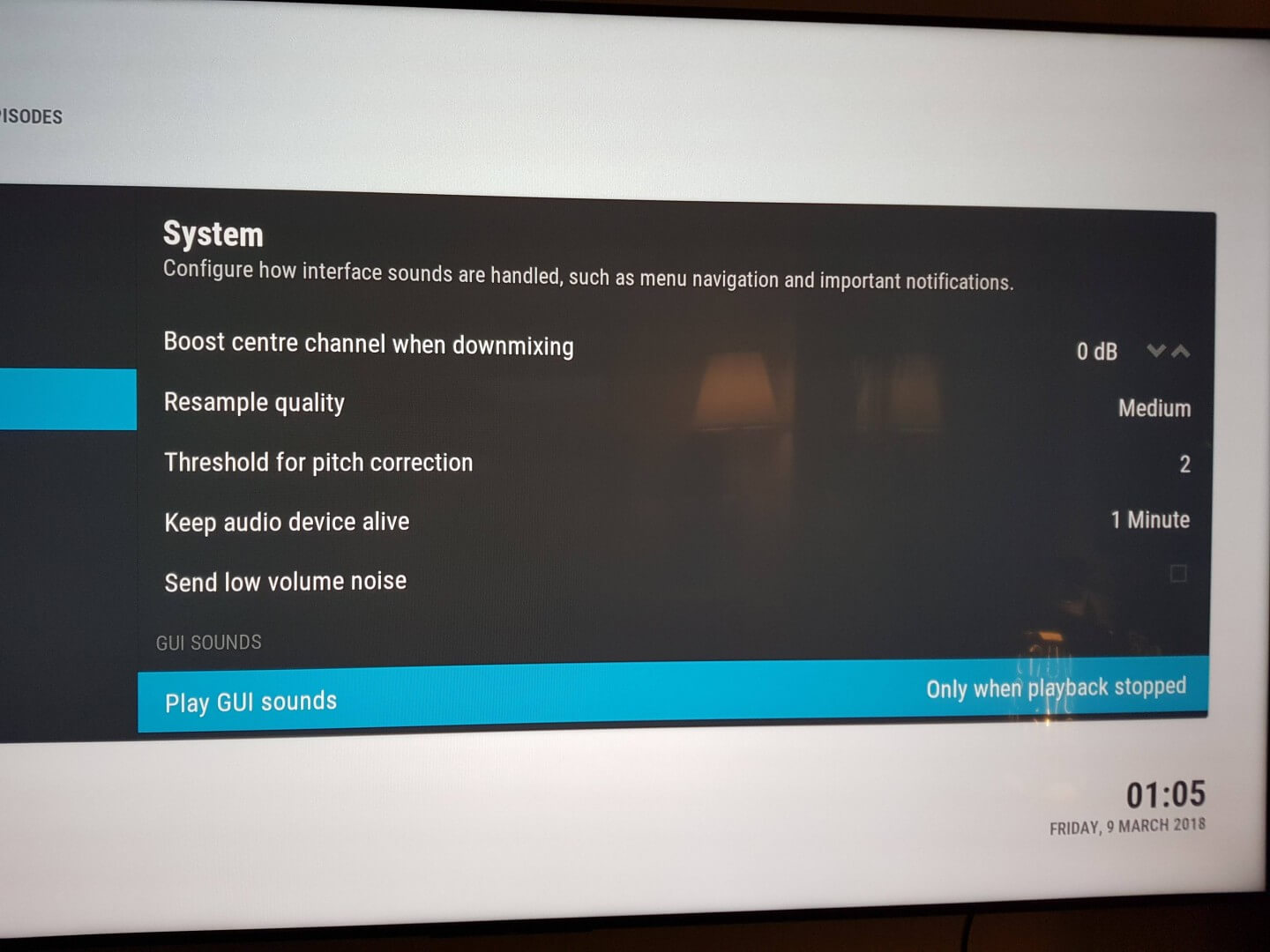

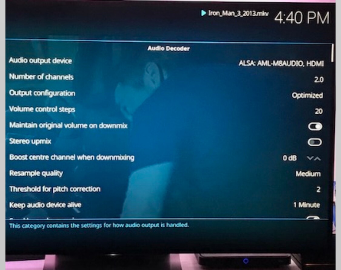

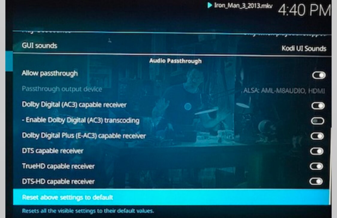

Just installed this on a Minix U9, everything's working except audio passthrough.
Since my receiver don't support HDR I have to connect the Minix directly to my TV, and then I'm using an optical cable to my receiver.
And the sound is working in Kodis GUI. I have three audio devices to choose from in "Audio output device" See below.
But down in passthrough, the audio device is greyed out, and I can't choose, HDMI is pre-chosen and I get no sound at all.
Just for the hell of it, I booted the Minix into Android and launched Kodi from there, and the only audio track available was "android audiotrack" on both regular audio device and passthrough device, and from there 5.1 passthrough is working!
I've also made sure not to enable Sync to display, since I know that disables the passthrough.
How can I get 5.1 passthrough working in Libreelec using an optical cable, since it working in Android on the same hardware it should work in Libreelec as well? Any ideas?
Thanks!
Have you reboot your box after changing these settings?! Sometimes i´ve to do it. Try select on picture 1 the HDMI output.
You must select only AC3 and DTS for optical audio out.
That solved it! I didn't think that ticking True-HD would disable sound completely! Thanks a lot!
You are not going to be able to passthrough DTS-HD MA and Dolby True-HD via optical .

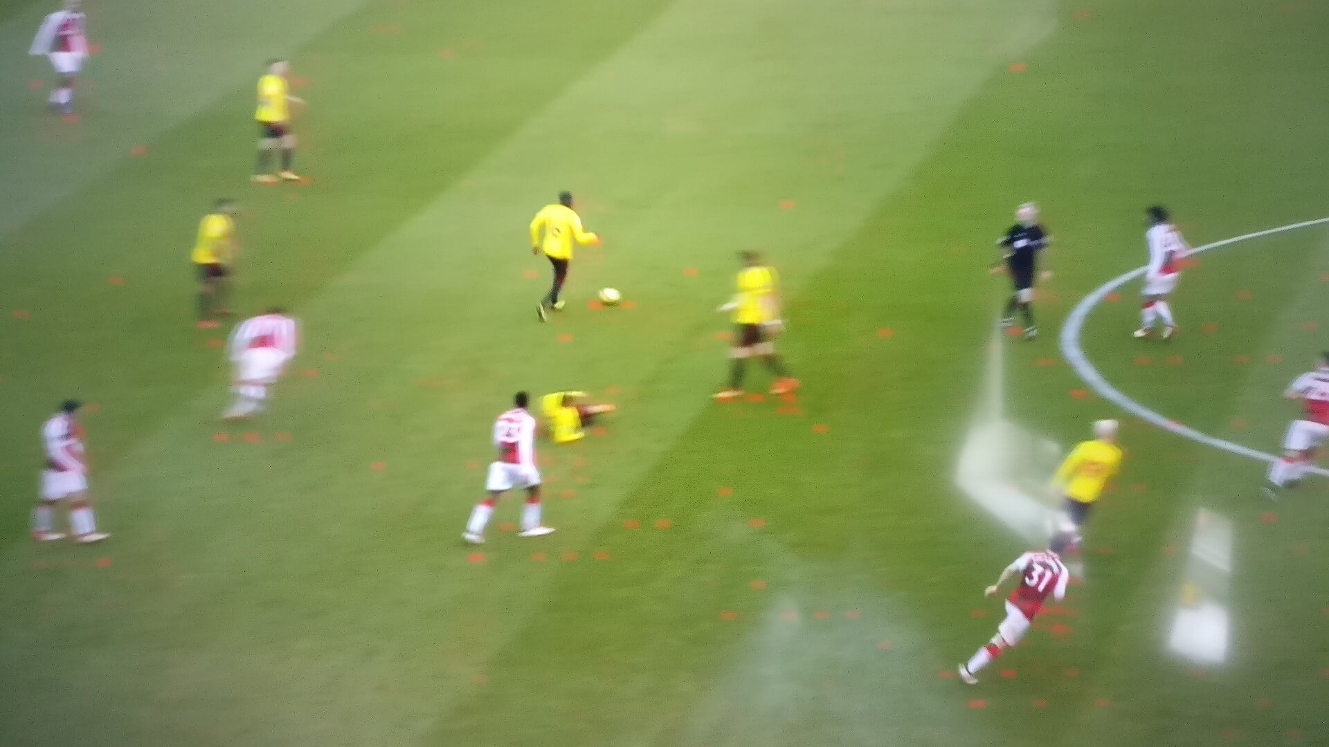

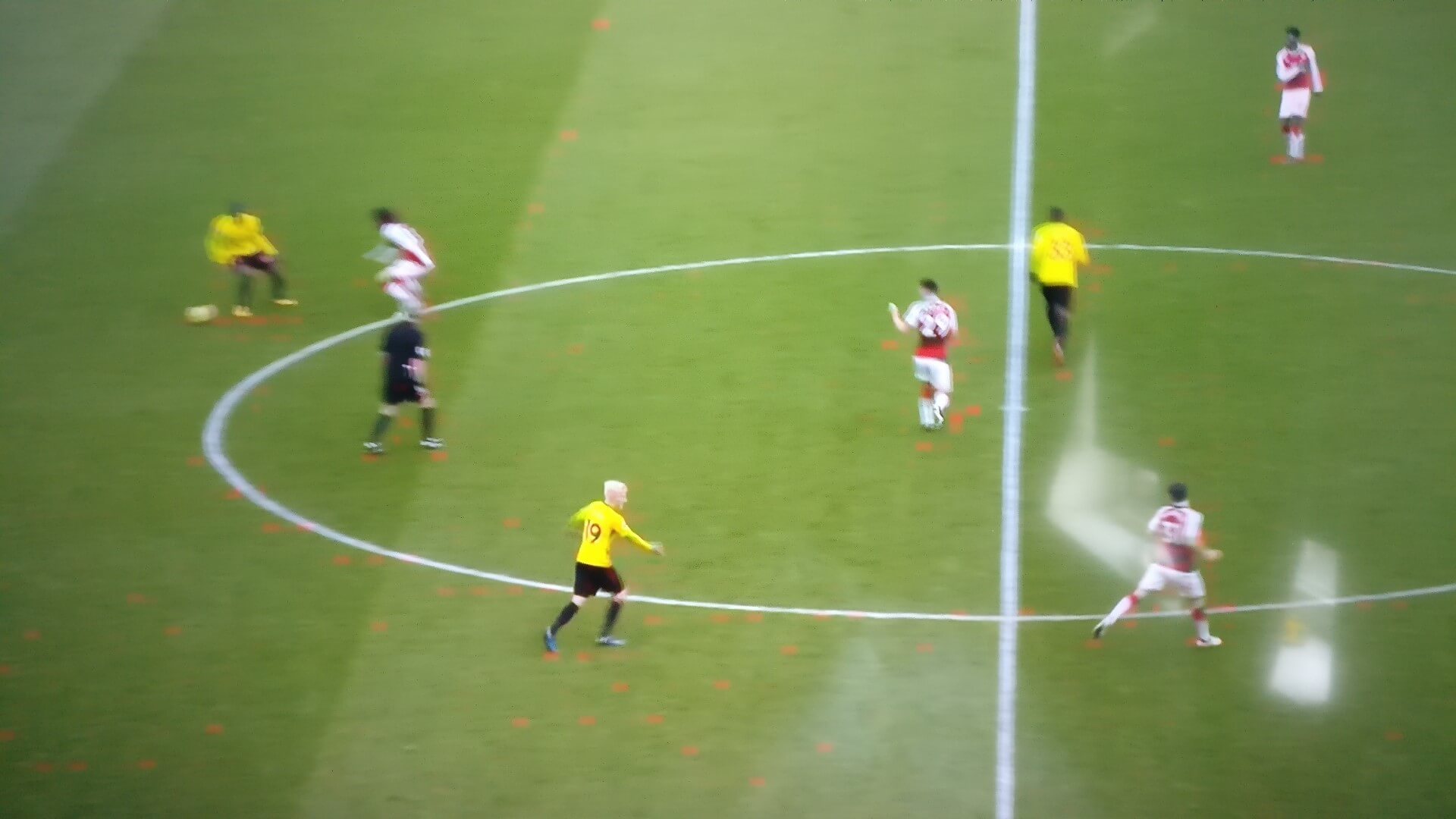

Does this fix the weird issue you get when watching live tv where the image looks like its degrading image?
Yes it's a deinterlaced picture fix that will remove picture ghosting and possibly sharpen up the image.

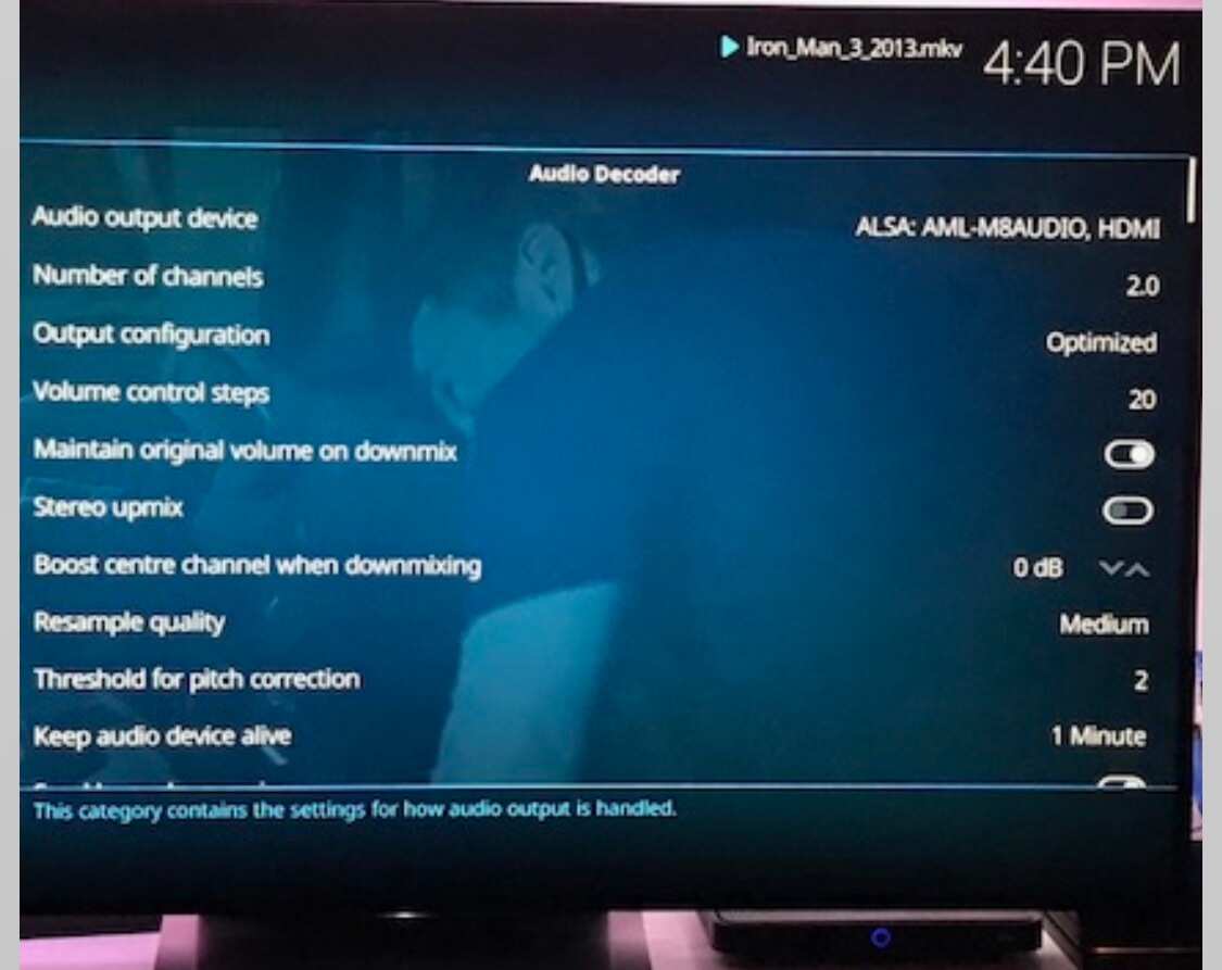

- for those with a decent 2.1 only audio system and playing 5.1/7.1 audio downmixed to 2.0 PCM.
Set the experimental "Include LFE in stereo downmix" audio option to 100% for extra audio punchiness from the subwoofer.

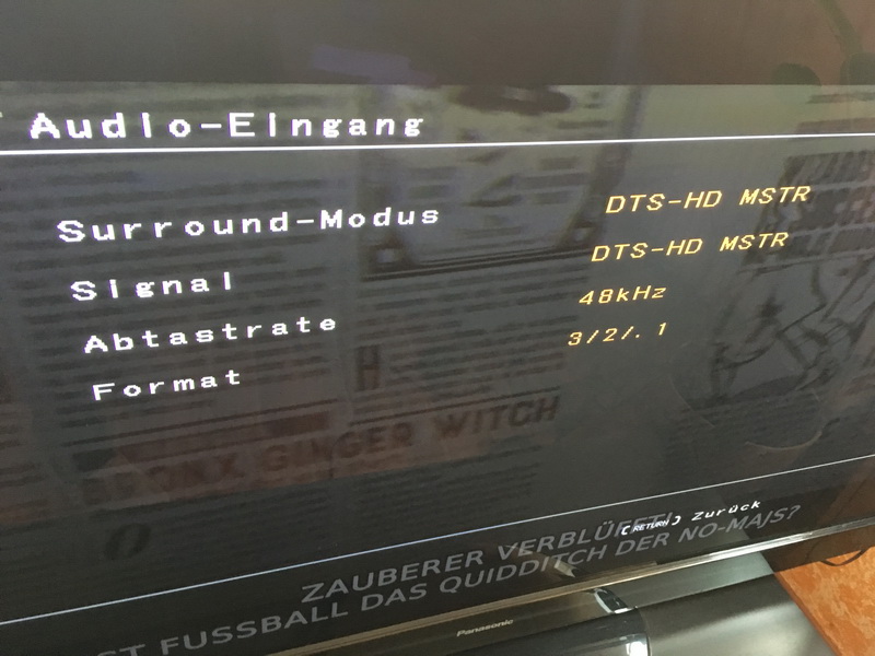

I use kszaq 8.2.2.3 build which is working perfect with HD audio passthrough to my Marantz reciever. Can I with this build improve the picture
quality by enable 422.10bit manually ? I am asking because I do not want to have any audio issues now when the passthrough is working so well
with this build.

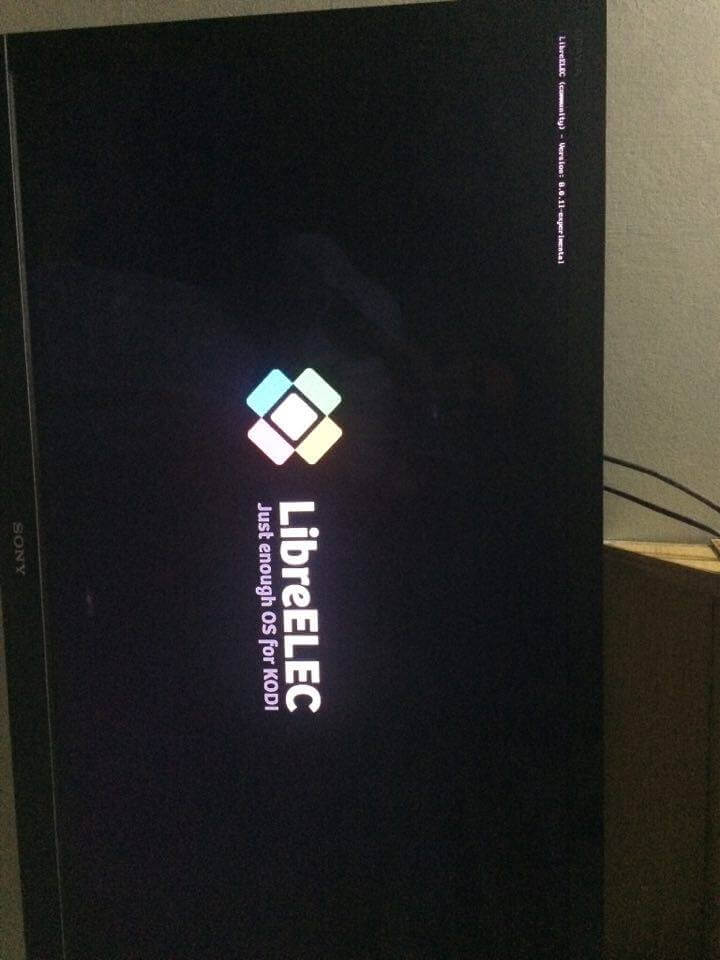

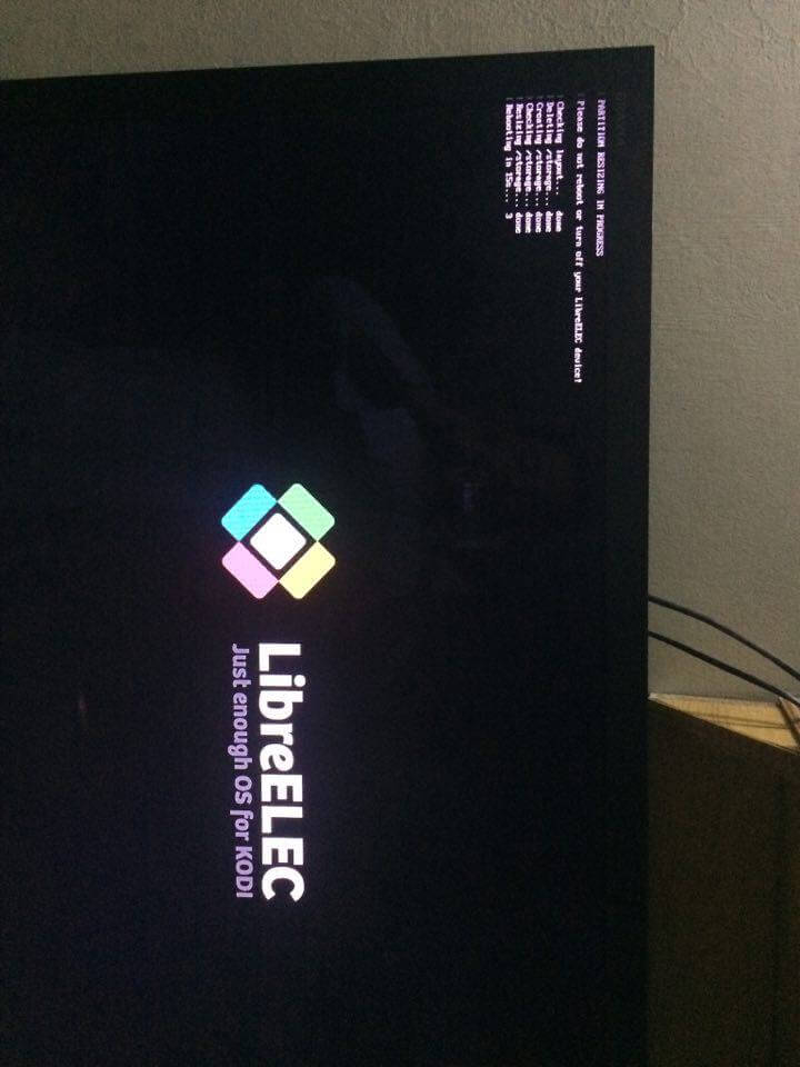

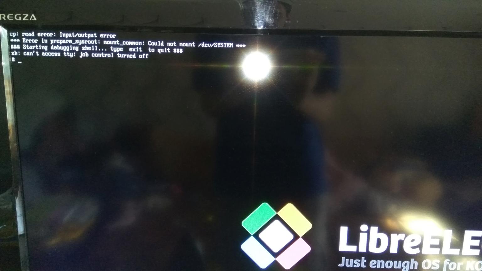

I’ve just tried to update to this build and now my box won’t boot it is stuck on the mecool logo, it’s a m8s pro S912 and I updated from 8.2.2.3 installed to internal.. how can I fix this? I can’t connect over the network
You can do it yourself:
echo 0 > /sys/module/di/parameters/nr2_enAlready have that set so it can't be that.
See all the red dots everywhere gets worse the longer you leave it, happens with live tv or recorded live tv. I think it's a 25fps problem as it doesn't happen with anything else. Changing the channel for live tv or skipping forward or backward for recorded tv fixes it until it randomly happens again

Wizzi07 it might be some sort of issue with a device tree. You might find newer compatible ones in the .img device trees folder included in the following post:
[8.2.2.3] LibreELEC 8.2 for S912
If your device is cactus see the Freaktab forum and reflash Android Firmware with the USB Burning tool software:
Of course you will have to flash the image first to a SD card to access the device tree directory.
The LE team and myself are not going to support or recommend Internal eMMC installs - there simply are too many people coming unstuck when doing it.
The failsafe, bulletproof (if you do not use in Android - the AMLogic Burning tool) LE eMMC copy method is this:
