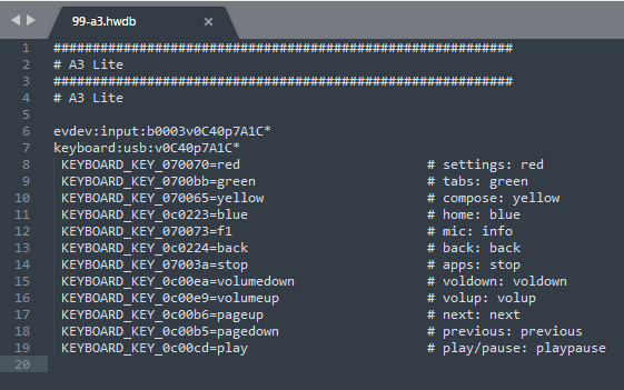

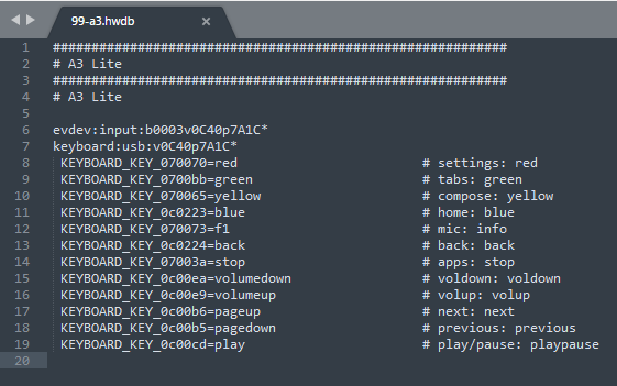

Here's my hwdb file for my remote all the buttons work once remapped
evdev:input:b0003v0C40p7A1C*
keyboard:usb:v0C40p7A1C*
KEYBOARD_KEY_070070=red # settings
KEYBOARD_KEY_0700bb=green # tabs
KEYBOARD_KEY_070065=yellow # compose
KEYBOARD_KEY_0c0223=blue # home
KEYBOARD_KEY_070073=f1 # mic
KEYBOARD_KEY_0c0224=back # back
KEYBOARD_KEY_07003a=stop # apps
KEYBOARD_KEY_0c00ea=volumedown # voldown
KEYBOARD_KEY_0c00e9=volumeup # volup
KEYBOARD_KEY_0c00b6=pageup # next
KEYBOARD_KEY_0c00b5=pagedown # previous
KEYBOARD_KEY_0c00cd=play # play/pause
Display More
I compiled from GitHub - kszaq/LibreELEC.tv: 'Just enough OS' for Kodi but just updated kodi to a later version than his one
Basically just did what this guy did Remap "Caps Lock" to "Shift" (Missing key on USB RF Remote, "Jump to Letter" feature) and remapped buttons to what i wanted
