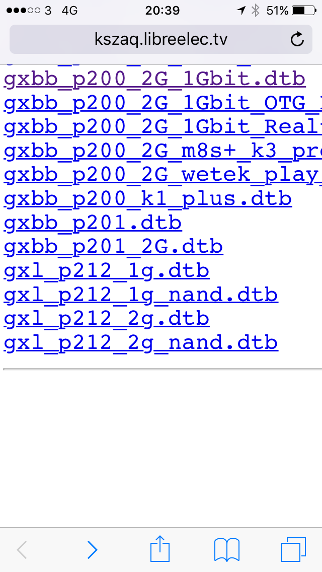

If you are talking about that user's MXIII II the one highlighted in your post is the wrong one for it - that box is a S905X and requires a GXL **** tree
specifically gxl_p212_2g.dtb
 True I didn't see the ii for the second gen

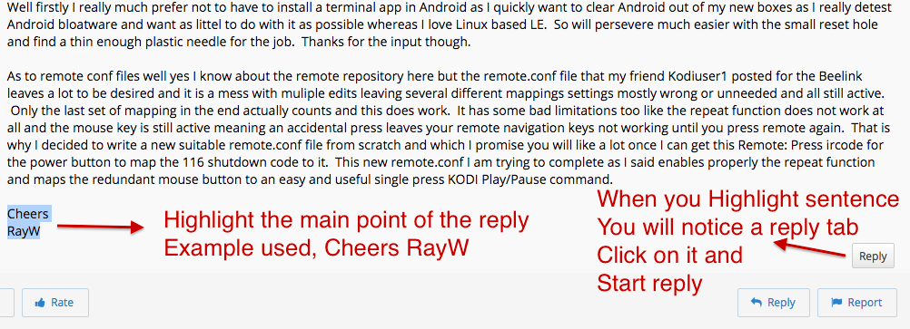

I've had the same problem. I've created a new remote.conf for my box and now it's working. Here is the HowTo (Title ' Create remote.conf from scratch ' ).

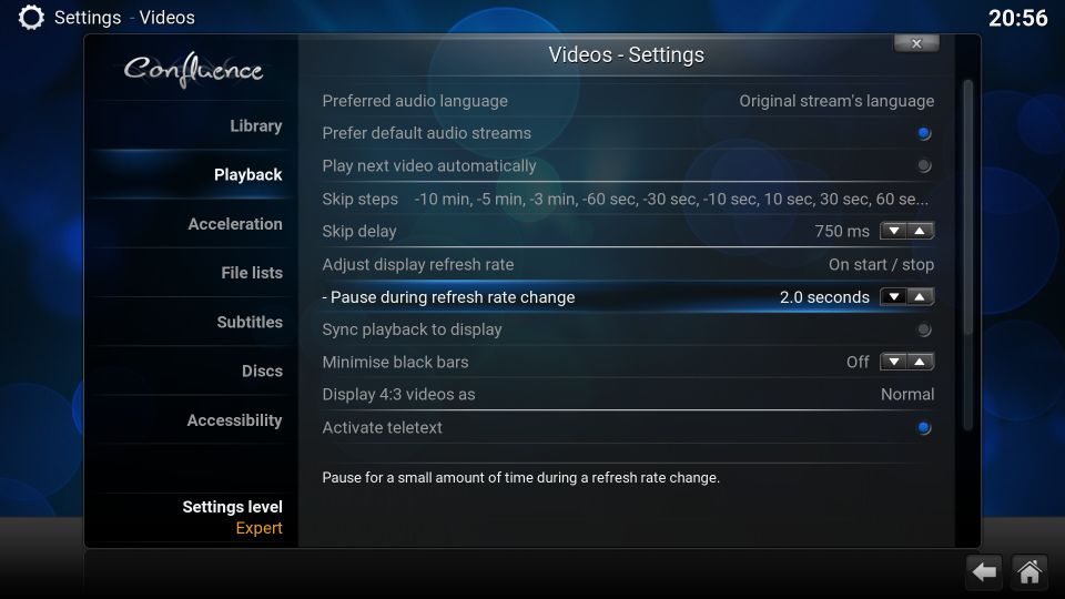

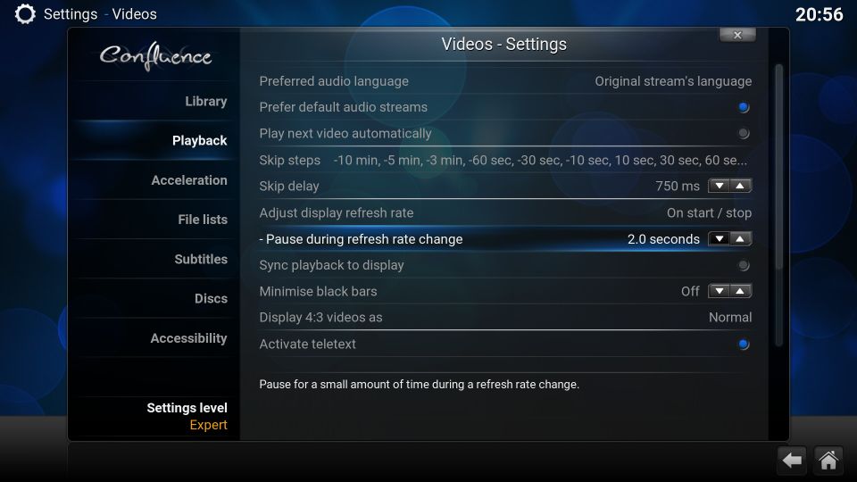

24p passthrough has always been out of sync with xbmc/Kodi, not just for amlogic hardware for me. LE defaults to a 175ms delay but not for these builds, I would suggest to include it :).
LibreELEC.tv/advancedsettings.xml at master · LibreELEC/LibreELEC.tv · GitHub
I am using the advancedsettings for the 175ms delay now, it works flawlessly! Again, thank you so much.
I just removed the unnecessary parts from the code:
<?xml version="1.0" encoding="UTF-8"?>
<advancedsettings><showexitbutton>false</showexitbutton><cputempcommand>cputemp</cputempcommand><gputempcommand>gputemp</gputempcommand>
 <video>
  <latency>
   <delay>0</delay>
    <refresh>
     <min>23</min>
     <max>24</max>
     <delay>175</delay>
    </refresh>
   </latency>
 </video><samba><clienttimeout>30</clienttimeout></samba>
</advancedsettings>

How do I flash back to android after installing LE on internal?I cant get my remote working with LE im gonna try starting over from scratch on Android and grab the remote.conf file again to see if that helps.
