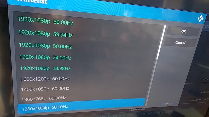

    Use the resolution whitelist and select all 1080p modes except 25, 29, 30 Hz.
    No such resolutions available for whitelisting for my TV.
