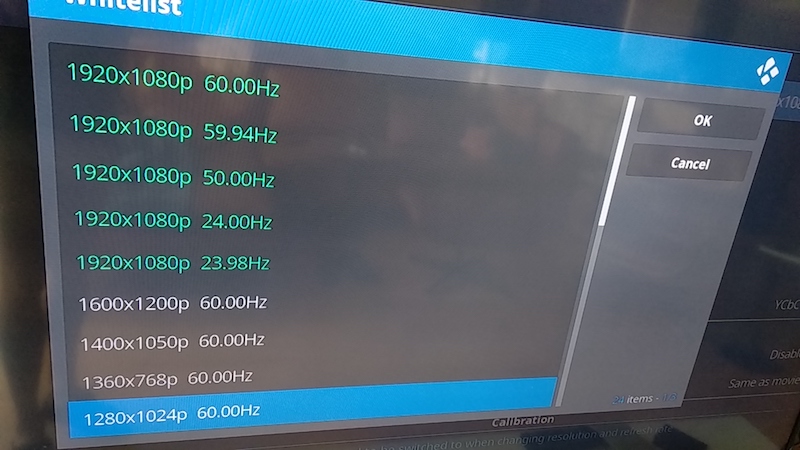

  • Use the resolution whitelist and select all 1080p modes except 25, 29, 30 Hz.
    Video from some TV channels shows up as 25fps and after some seconds Kodi detect it is interlaced and 50hz and switches again.
    If you start with 50 Hz (25 Not allowed) no unnessearry switching.
    No such resolutions available for whitelisting for my TV.

  • Setup the GUI Refresh Rate to 50 Hz in settings -> system -> display, so switching to TV does not change refresh rate.
    Whitelist Looks fine to me.
