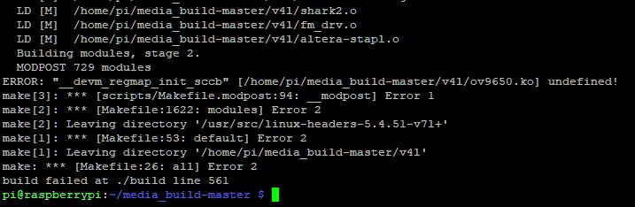

  • I am trying to execute Crazycat system build in a RPi4 with Raspbian to support HDstar tuner. I am stuck in the following problem: ERROR: "__devm_regmap_init_sccb" [/home/pi/media_build-master/v4l/ov9650.ko] undefined.
    I appreciate any help or clarification on how to clear this.
    Would love to hear how you get on, I had trouble getting this to work on a RPi4 and gave up!
