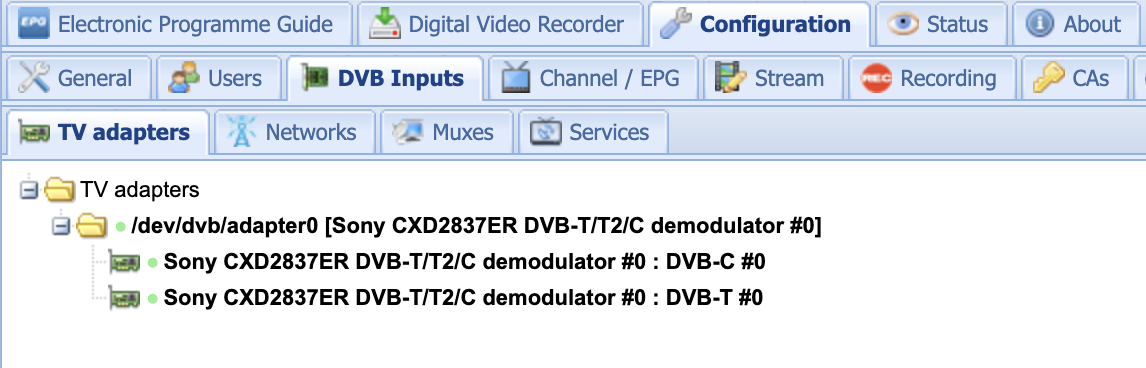

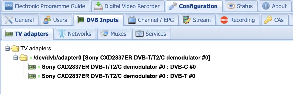

ashi At the moment the demux driver is an ugly port of even uglier Amlogic vendor code with support limited to the ~3 devices that myself and rozpruwacz have (and I have WP2 with DVB-S/DVB-T modules). Some work on a clean rewrite of the driver has started, but needs to be revived and moved forwards. The goal is to make all the drivers modular so technical implementations of demod/tuner/demux can described entirely within device-tree without relying on a single/monolithic driver with baked-in known combos of chips, which is how the vendor kernel works-ish. It's probably not a quick task happening in the next few weeks.
For the sake of asking, what chips are in the Mecool box and can you point me at a device-tree file?
