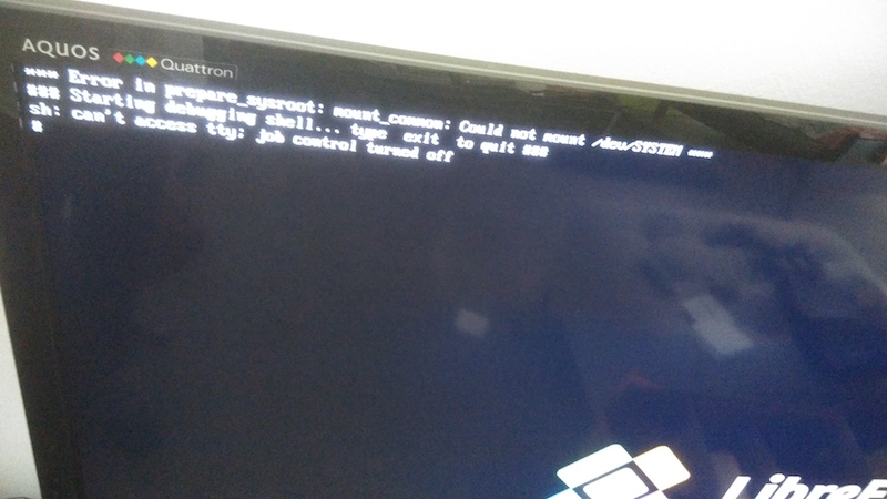

    EDIT: I resumed my on off reboot testing and spent 40 Minutes just re booting and powering off with the remote and no Freezing after about 80 on off and reboots. YES 80 TIMES BEFORE I GOT THE FREEZE.
    I cold booted and it booted fine.
    Did 3 more without a problem.
    I think i'm done for now. This is either fixed or it is a bug. I'm not so sure after what i have gone through.
    My box did this once when re booting, See screenshot.
