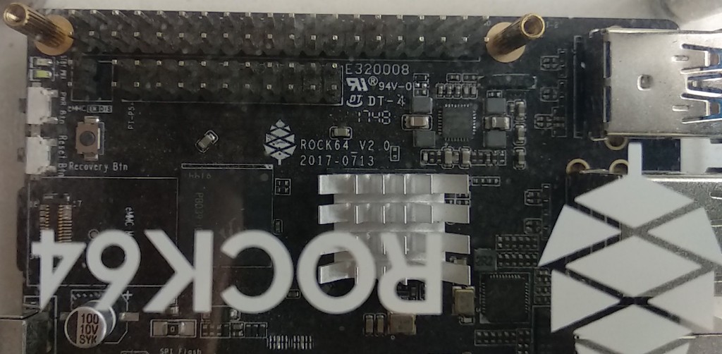

    I believe we have the same ROCK64, as least the circuit board is the same. The heat sink I have can only cover only the RK3288 processor. It's about 13 x 18mm in size. My Odroid-C2 is equipped with a much bigger heat sink. Heat sink on Rock Pi 4 is also bigger.

    Carey, I share your feeling on ROCK64, only I've never experienced kernel panic. I bought my ROCK64 SBC in 2017. FYI, the board marked ROCK64 2,0 2017-0713 with date code 1704. There is no eMMC and I used only 16GB microSD card. I got the same 5V3A AC adapter as you did, together with the remote control from PINE64.

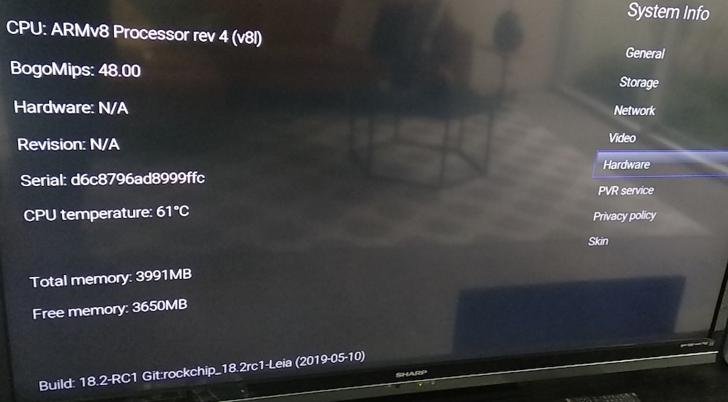

    I've seen the Temp at 75c at one point which is something I'm not used to seeing in my TX7.

    I have the ROCK64 board for over a month. I installed the heat sink (with conductive tape) that came with the board. Even with the tiny heat sink installed, the temperature is still very high (up to or exceed 70c), which is unusual when compare with other S905x TV box. I cut a square hole on the chassis (it fits perfectly with Raspberry Pi), hope to help lowering the temperature. Right now, it is used as TVH server and so far so good (no hang, no freeze). Guess temperature would go much higher if playback mainly uses software decoding. I planned to change to a bigger heat sink and employ thermal conductive paste but have not set a time yet.
