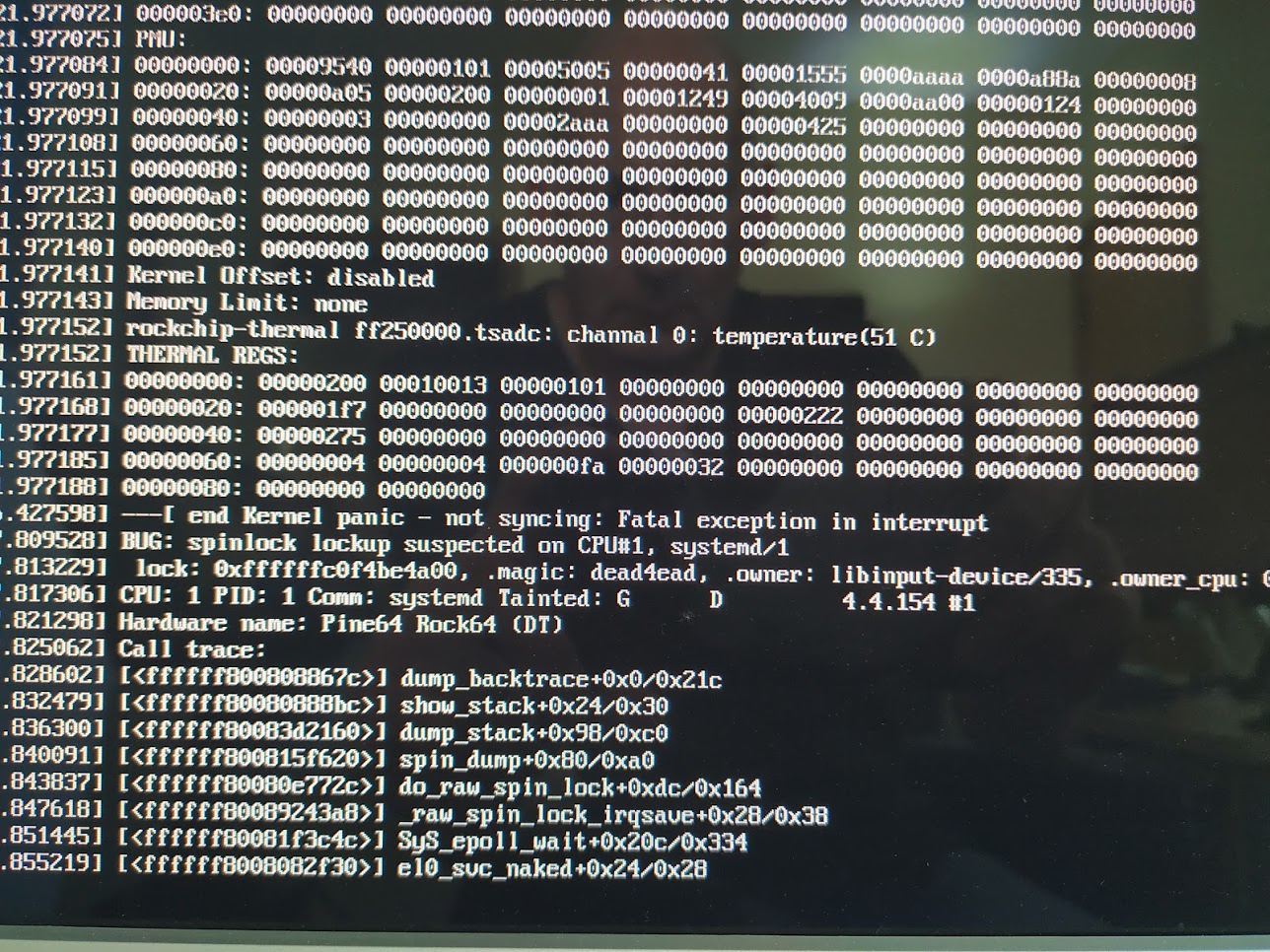

    The reason I'm asking is because I honestly don't know if I have a bad board or not. I can get some versions of linux I download and install to work, and some have kernel panics. Same with Android. Every version of LE I've tried has kernel panics on random boots, and HW decoding doesn't work. But once it did play back with HW decoding, maybe twice.
    I've spent many many hours now experimenting, trial and error, and searching forums online. I'm not the only person having the same error messages and kernel panics with this rockchip. Currently it appears to me to be a simply a bad purchase of a problematic board and/or chipset.

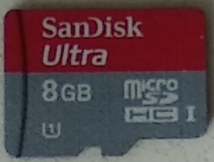

    Maybe something also causing problems with rev3 boards and micro-sd cards.

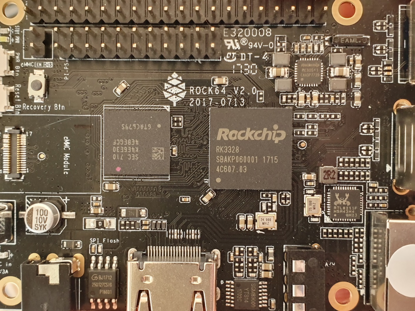

  • Carey, I share your feeling on ROCK64, only I've never experienced kernel panic. I bought my ROCK64 SBC in 2017. FYI, the board marked ROCK64 2,0 2017-0713 with date code 1704. There is no eMMC and I used only 16GB microSD card. I got the same 5V3A AC adapter as you did, together with the remote control from PINE64.

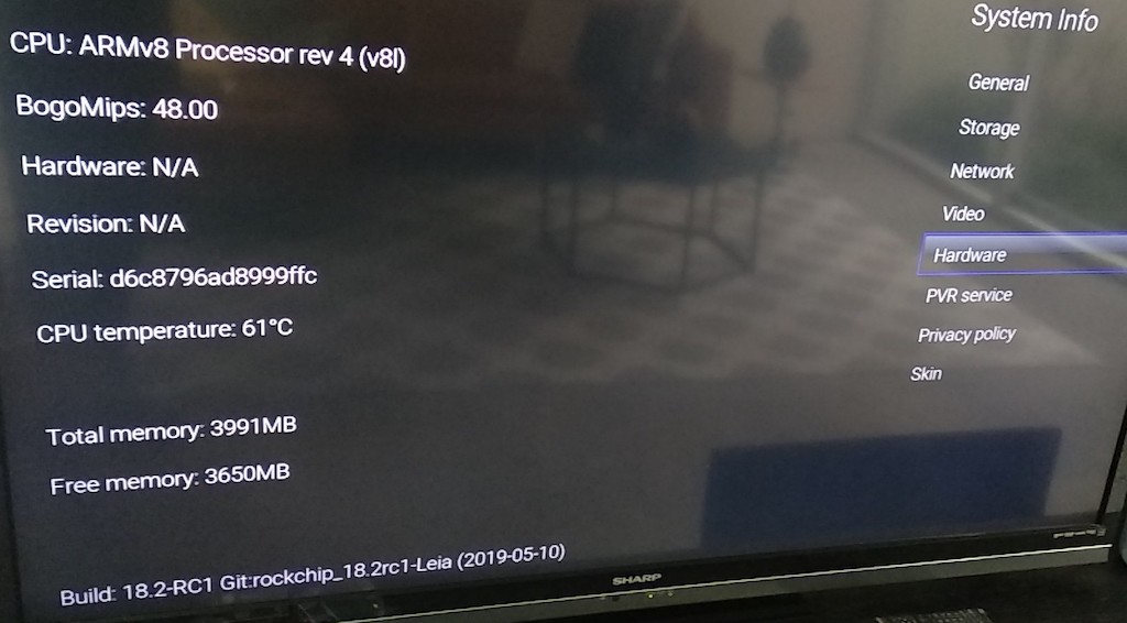

    I'm not using the power adapter sold by Ameridroid. I purchased a 5V3A unit new from Amazon. I've also tried another 5V4A PS that I purchased surplus, same results, which I've used on other SBC's without an issue.
    I'm using the heat sink that Ameridroid sells for this board. The temp shown using the heat sink in LE hardware screen is around 60C. Below the 80C that I've read that people say the board shuts down or throttles at.

    But when I stopped playback of one of the versions of BBB, the board locked up upon returning to the GUI. I hit reset, the next boot had kernel panic. Reset again, it booted fine, test played all the same videos, played back perfectly again, including my HEVC and 4K samples using HW decoding.

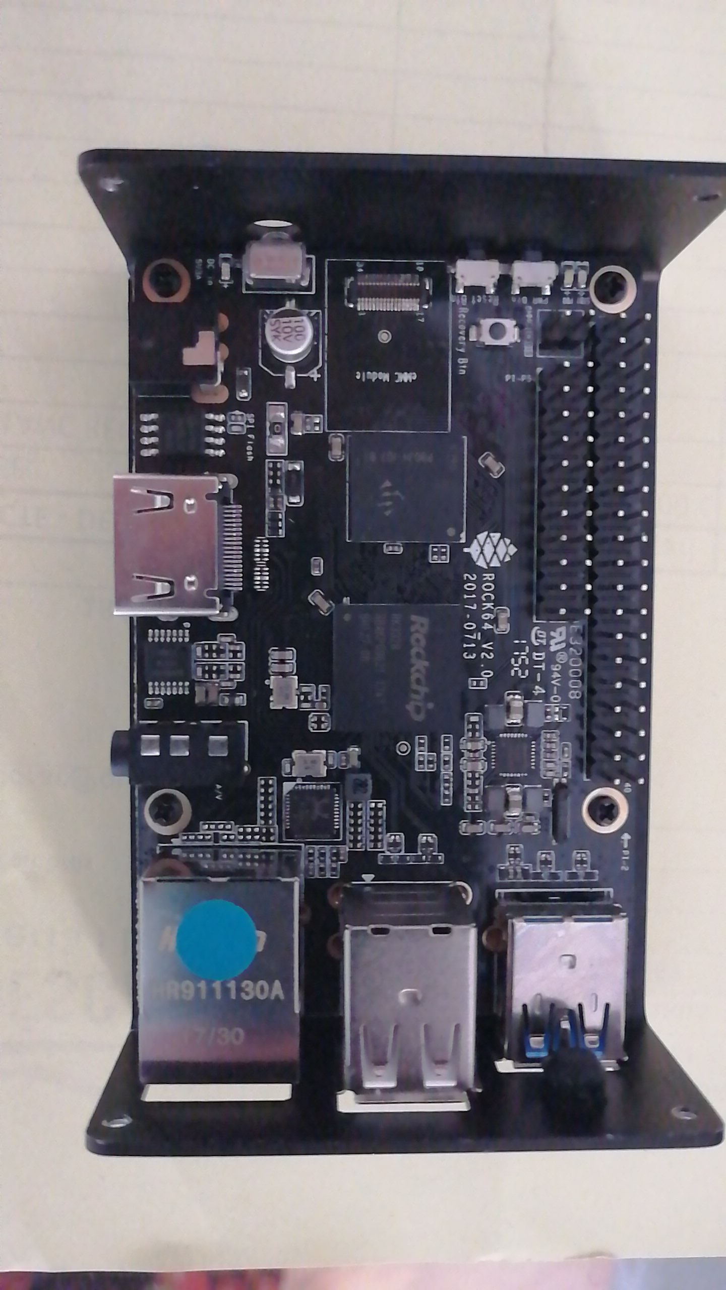

  • No issues comparable with any of the above with my Rock64 .
    I am using the Factory Power Supply.
    LE Via SD Card. 4gb Ram.
    Rock64 HDMI straight into TV.
    One USB stick and one USB receiver for remote inserted.
    See my Board. Just to compare.
    Edited once, last by kostaman (May 12, 2019 at 7:10 AM).
  • Comparing the silk screened text on your board and mine are the same other than the code 1748 on your board. In that spot my board has 1752.
