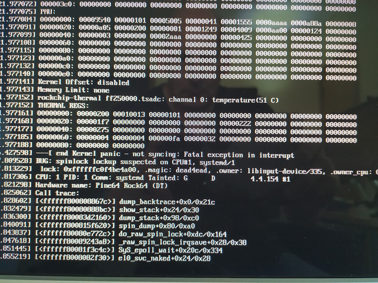

    I wrote today's nightly image to the SD card, dated today 05-09. It boots, expands the OS to the card, reboots on it's own, and hangs at a kernel panic. I took a pic where it stops and attached the image. In case someone reading this knows if this looks like an LE OS problem or a hardware problem.
    For example it says:
    Kernel panic - not syncing: Fatal exception in interrupt
    BUG: spinlock lockup suspected on CPU#1, systemd/1
    This is first boot after install.
    That explains at least something, but now we need to find out why the Video FFU and the IOMMU crash. Are there any devices attached to the Rock64? What PSU are you using?

    Often after booting to the point of getting the LibreELEC logo, there are kernel panic error messages, memory dumps to screen, then just hangs.
