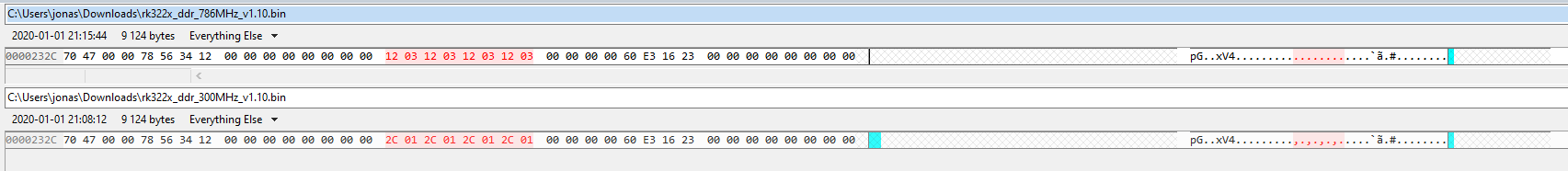

    Please try the ddr blobs I just patched to hopefully init ddr at 786MHz speed at rk322x: add ddr v1.10 and miniloader v2.56 · Kwiboo/[email protected] · GitHub, I used the same technique on rk3328 ddr blobs to get a 786 and 933 MHz blob.
    01 2C = 300
    03 12 = 786
