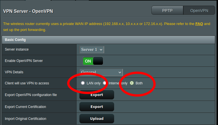

  • Hello, i have a specific networking problem and i’d much appreciate some help.
    I have Asus router (192.168.2.1) with openvpn server running on it (TUN, 10.8.0.0/255.255.255.0), so i can have access to my home network from the outside. On my Vero 4k (192.168.2.5) i have Surfshark VPN, managed through Zomboided addon. If i’m on my home network, i can normally access Vero4k (NAS, Transmission etc). But when i’m connected to my home network via VPN, i cannot see Vero4k or access NAS etc. I can do that only, if i disconnect Vero 4k from the Surfshark VPN. Any hints? Thank you.

    First check that your OpenVPN server settings allow access to your home network.
    Second, stop using device names and use IP addresses to find devices.
  • Hi, thank you for your answer. On my Asus/Merlin Vpn, i can access all other devices on my LAN, except Vero4k, when it has Surshark Vpn enabled. Client VPN is set to both, lan+internet. I'm using IPs all the time. I think i have a routing problem, but i duuno how to solve it...
  • With Surshark VPN enabled SSH into the device and type 'ifconfig' then you will see all the IP addresses of your device; your router knows the ethernet and wifi range. Those are the addresses to use remotely.
    Added: I forgot to say that if you connect to your Asus server from a home network with the same range of IP addresses as you have on the Asus home network, there may be conflicts and not work. In this case change the address range of your home network (for example, from 192.168.1.0/24 to 192.168.168.0/24).
    Edited once, last by elonesna (February 2, 2022 at 5:42 PM).
  • I'm connecting to my home vpn through android open vpn app. My router home ip is 192.168.2.1 and my vpn subnet is 10.5.0.0. When Vero4k (rpi) is on surfshark vpn, i can't see destination tun0 10.8.8.0, gateway 0.0.0.0 and genmask 255.255.255.0.. I can see samba shares at home on 192.168.2.5, also when i'm on asus vpn and surshark is disabled on Vero 4k. As soon as i enable it, i can't reach it.
