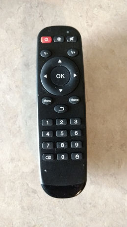

I have a QBox, which often comes with the remote in post #11.
My remote, however, looks like this.
Whatever remote.conf file I copy to the .config directory fails to work - pushing buttons has no effect and I need to ssh, delete the file and reboot to gain control.
Anyone have a qbox with this remote? Or, should any remote.conf built for this remote work on my machine?
