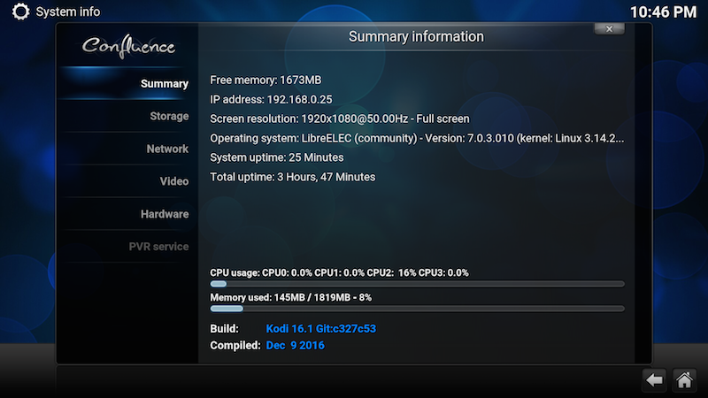

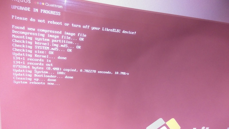

  • From my logs i see :
    ################ SYSTEM INFO ################
    Date: Fri Dec 9 22:13:34 UTC 2016
    kodi Options: --standalone -fs --lircdev /run/lirc/lircd
    Arch: aarch64
    Kernel: Linux 3.14.29 #1 SMP Fri Dec 9 01:31:42 CET 2016
    Release: LibreELEC 7.0.3.010
    ############## END SYSTEM INFO ##############
    I used the LibreELEC-S905.aarch64-7.0.3.010-USB-Revert.img.gz no device tree added.
    into the Update Folder and rebooted but i don't know if the update really flashed.
    See screenshot as well.
    Same random freezes.
