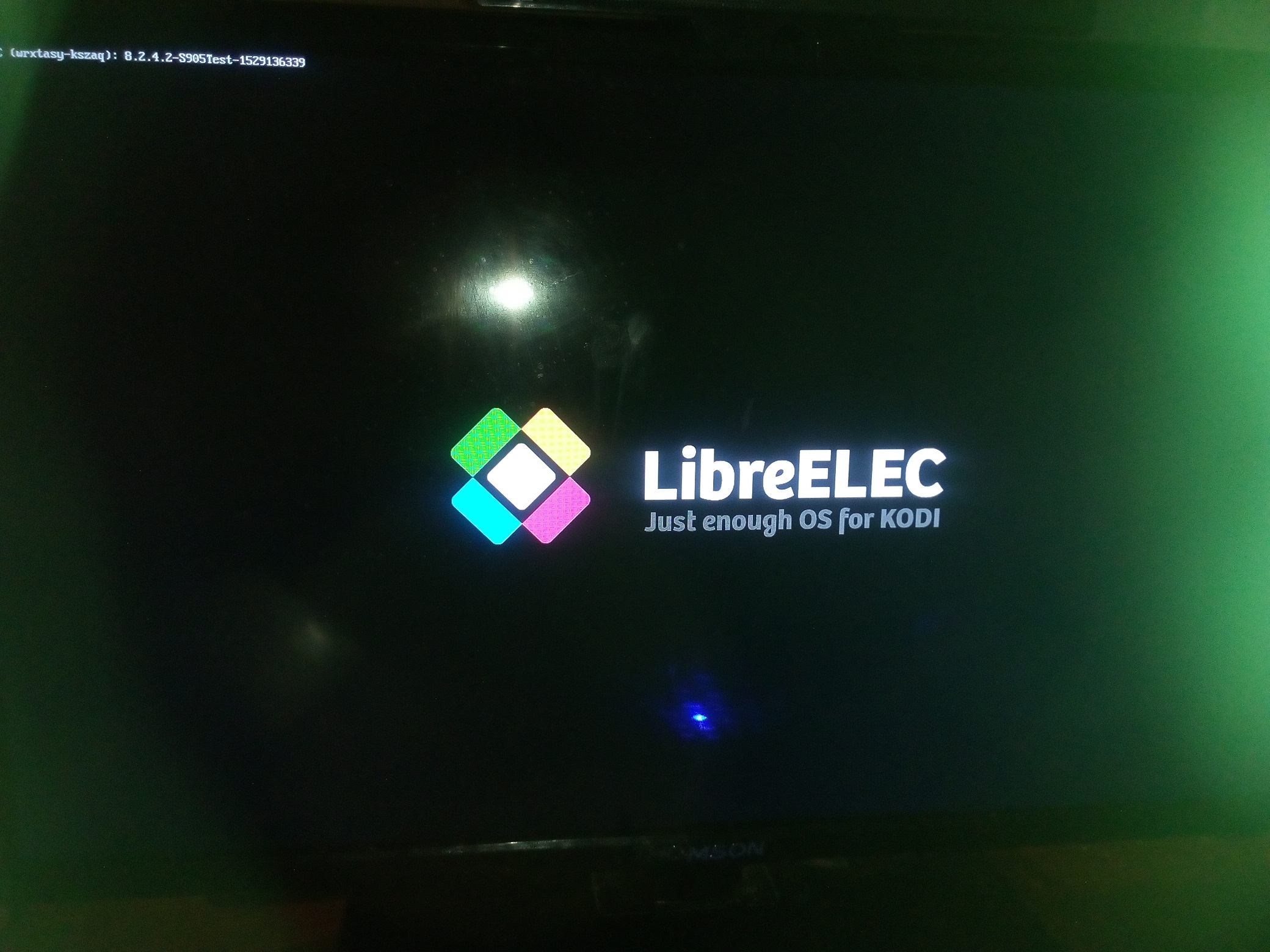

  • Facing some issues with
    • M8S PRO L
    after installing the latest version of LibreELEC , LE 8.2.4.1 – S912:
    I have copied the gxm_q201_3g.dtb and renamed to dtb.img
    (mine is 3GB,100Mbps, https://kszaq.libreelec.tv/s912/8.2/device_trees/100mbit_ethernet/) and I got a successful boot for LibreElec
    I have two issues.
    1. The OSMC remote worked for a while, then it stopped working, SO I copied the remote.conf from http://wrxtasy.libreelec.tv/mecool/
    Post that remote is working..
