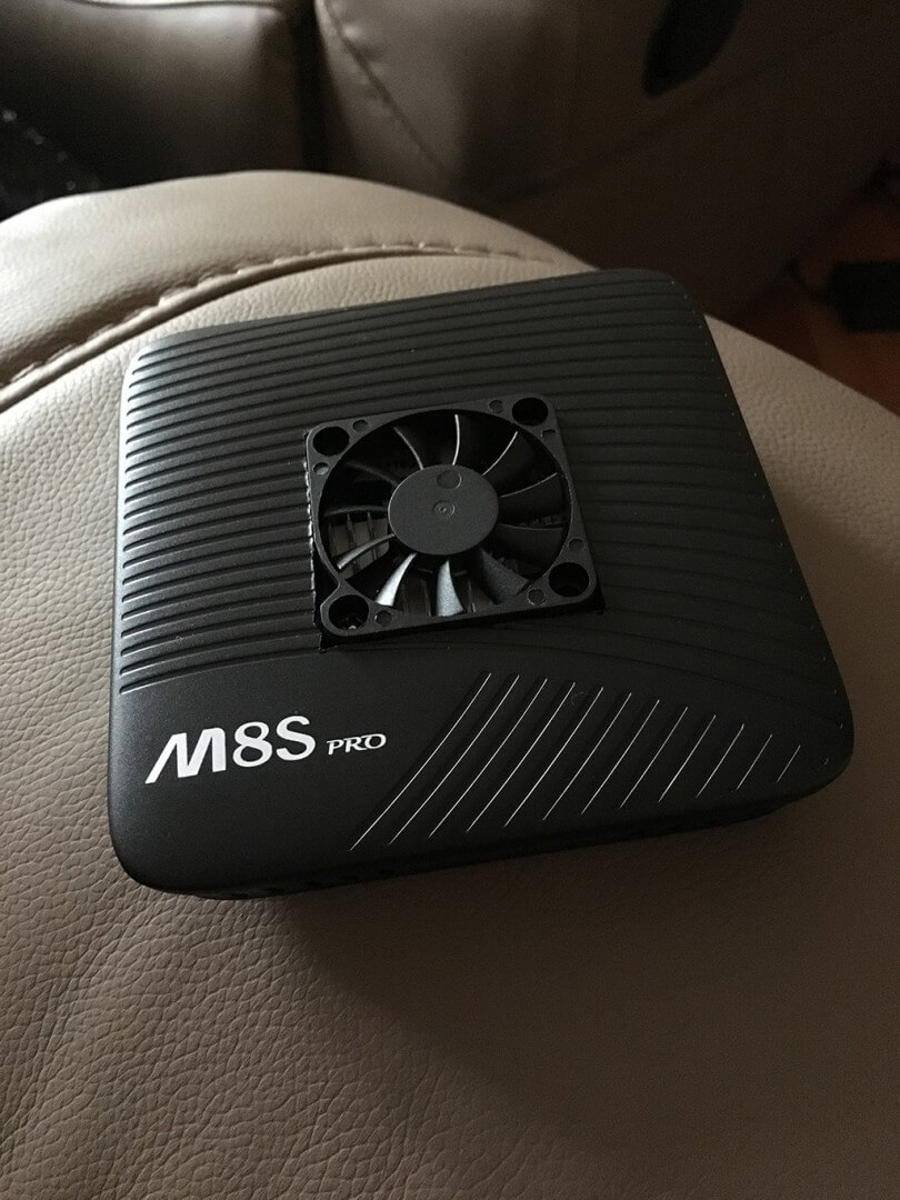

    I have modified my M8S Pro with 40x40x10 Fan on 5V:

    Cheap AML hardware with cheap internal components and without proper thermal cooling and heat sinks - when Overclocked will very likely crash or show other strange picture output behaviors.
    Time to open up and mod your device then like mirbg 's cool setup pictured above.:thumbup:
