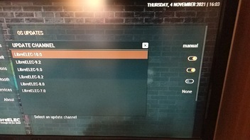

Display MoreThe final version of LibreELEC 10.0.1 has been released, bringing Kodi (Matrix) v19.3 to LibreELEC users.
Users of LibreELEC 10 Beta or RC1 get an automatic update to the final version. LibreELEC 9.2 setups will not be automatically updated, you will need to manually update.
