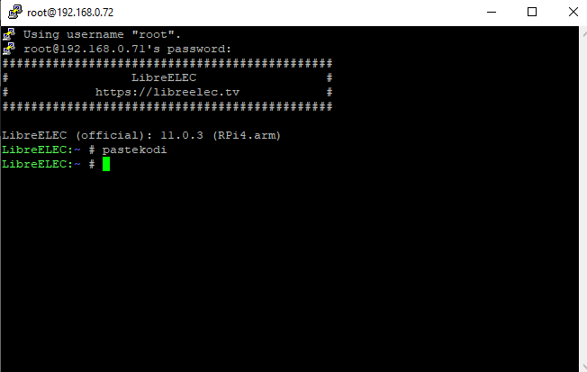

    I couldn't get the log file, no matter what I tried. Anyway, I installed Matrix on the RPi4, and so far so good. I do get the occasional reboots when I scroll through the library, or if I try to load YouTube, TMDB Helper and a few others. I actually just tried to use the pastekodi command, but just like with Nexus, it returned the command prompt, so that may be a problem if I need assistance. Unless there is some other way I can gab the log because both methods don't seem to work for me.

    Please provide pastekodi/pastecrash logfiles, system configuration, journal etc are extremely important, pure kodi logs don't help heere
    Please provide a full debug log.
    How to post a log (wiki)
    1. Enable debugging in Settings>System Settings>Logging
    2. Restart Kodi
    3. Replicate the problem
    4. Generate a log URL (do not post/upload logs to the forum)
    use "Settings > LibreELEC > System > Paste system logs" or run "pastekodi" over SSH, then post the URL link

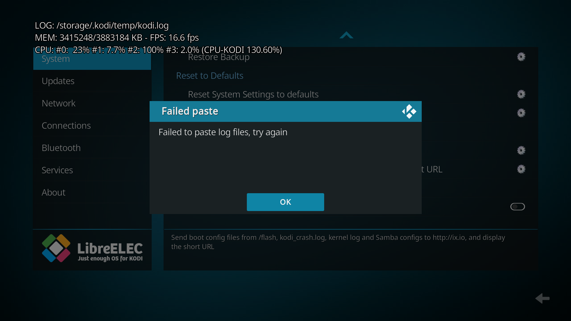

    When I try to perform the action, I get the following error message.
