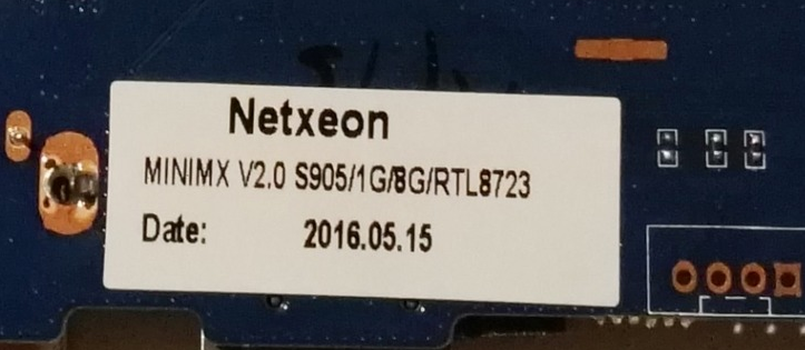

  • Apparently the file is not correct for the remote you have. You may want to look for other files with remote in the beginning and conf at the end, like remotesecond.conf. Rename in to remote.conf, copy to Config folder and reboot.
    We figured it out. After editing the original remote.conf to remove the "custom_begin" tags and the unused second layout, Cold5 reported it as working (link). :)
    Also I noticed the edited mini mxIII II file is almost the same as I had on my mini mx (link). So it seems some device has the same remote that had the original mini mx. Also It looks the same on some webshops, too.
    The idea of removing the custom_begin come from the same situation with my v88 pro, I had to use an edited file with that device.
    Btw, first I suggested Cold5 to share the remote.conf from the sd card's boot partition after first start, because it was easier to get. But that file was empty as he said. So he got the file from android, finally.
