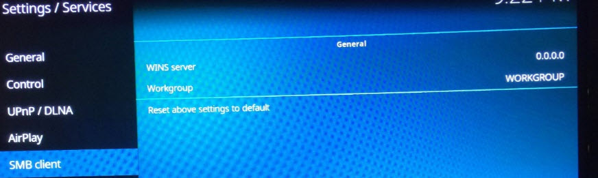

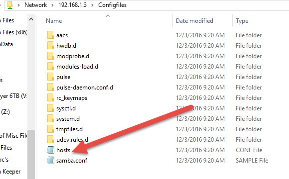

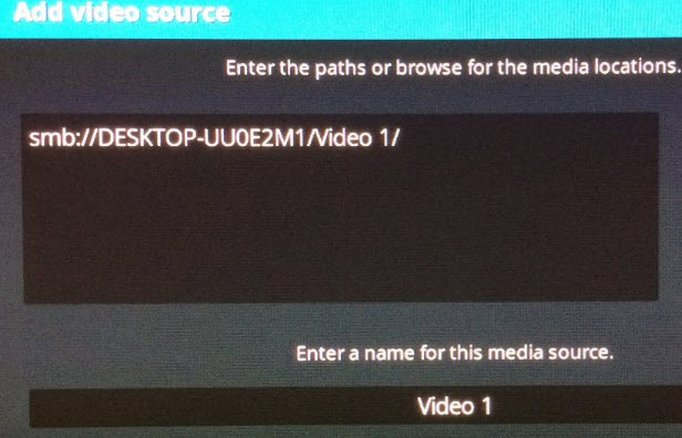

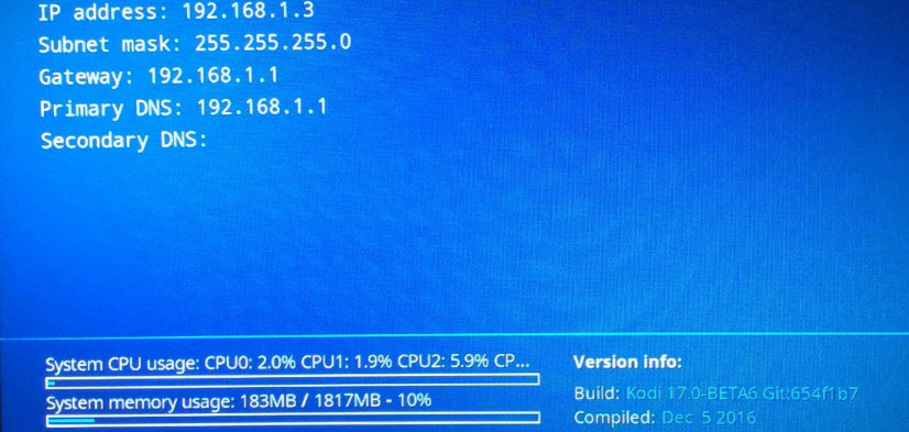

Hi OutCave, Still Must be missing something The first image is where I am Editing the file? I cant seem to locate the Storage folder? The Second Image is my workgroup name. The third Image is my Ip address on my Odroid & the 4th Picture is my is what the Smbshare looks like pointed to my Movies files. Could you possibly show me what my Hosts.conf file should look like with the info I provided? & some guidance on how to get where /storage/.config/hosts.conf is if I am not looking in the correct place? I just remoted in with the Ip of of my odroid but I am not sure if that will work.
The Ip for my my Media server is Picture #5
Any Help Greatly appreciated. After this I should be golden with the Latest release of Kripton it looks Fantastic!!!
Your hosts file will just say
Code# hosts.conf # This configuration file allows you to manually map hostnames to# IP addresses # Format: <ipaddress> <hostname1> <hostname2># Example: 192.168.0.3 openelec openelec.mynetwork # NOTE: do not edit /etc/hosts directly# edit /storage/.config/hosts.conf then reboot 192.168.1.2 DESKTOP-U0whatever 192.168.1.3 LIBREELEC
Probably the LIBREELEC entry isn't necessary.
It's imporant you use static IPs of course.
Also, when you add SMB share movies to Kodi via the GUI, you can use the IP address manually instead of choosing 'Browse'. This can be more reliable in my experience.
Thank you for the reply, I will try that when I get home, Can you please give me a little more info on how to get to the file Hosts.conf I can remote in through windows but am not seeing /storage/.config/hosts.conf ( I can put the file in the ConfigFiles directory where the Dummy Host file lives) Will that work? Or is there some other way to get to it. The first screenshot shows what i see when i remote in. Sry guys just learning my way through.
Thank you for the reply, I will try that when I get home, Can you please give me a little more info on how to get to the file Hosts.conf I can remote in through windows but am not seeing /storage/.config/hosts.conf ( I can put the file in the ConfigFiles directory where the Dummy Host file lives) Will that work? Or is there some other way to get to it. The first screenshot shows what i see when i remote in. Sry guys just learning my way through.The one that you see in your first picture above is the hosts file. It just doesn't have any entries yet.
All you have to do is add the entries to it and save (making sure to keep the .conf extension) then reboot -
