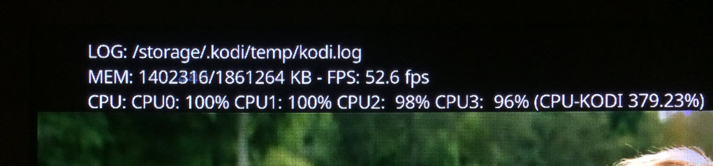

    Hi guys First off 720p plays flawless. 1080p files are Stuttering jerky. Larger files above 10 gigs buffer symbol comes up a lot.
    I have tried this directly off a USB flash drive and my Samba network connection, no change in playback
    Also My desktop pc plays the files fine and my popcorn hour a210 plays them fine.
    I am using Odroid C2, with 32gig emmc connecting with gig lan connection.
    I am using LibreElec (Kripton) v7.90.009 Alpha Love this release!
    My files are stored on File server using Samba , also tried on Usb flash drive
    Logfile is YEDX (For some reason I can not assess this Address at work it is blocked)

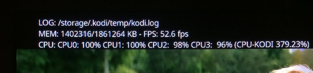

    See Screen shot of mem usage and Cpu Usage, This 10 gig file Runs almost all Cpu's up to 100% & Kodi Cpu up to 379.23 % Something dosent seem rite.
    I am not thinking it is a network issue because i can plug a usb drive directly into the C2 and it still is jerky. Plus I can plug the Popcorn hour into the same lan cable and it will play the file fine. And the Popcorn hour is only a 100mbs connection.

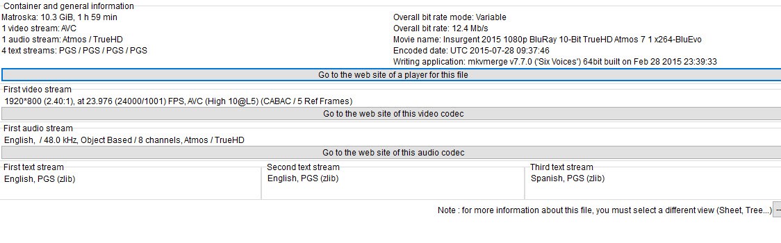

    Second screen shot is the media info of the file.
    I did also want to add that i tried HW acceleration is enabled & disabled, Disabled made it mush worse?
    Any Help appreciated. Thank you!

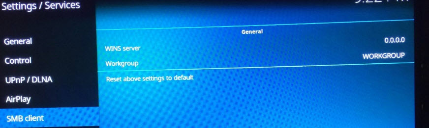

    Hi OutCave, Still Must be missing something The first image is where I am Editing the file? I cant seem to locate the Storage folder? The Second Image is my workgroup name. The third Image is my Ip address on my Odroid & the 4th Picture is my is what the Smbshare looks like pointed to my Movies files.
