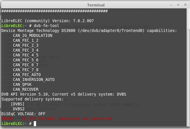

    I do have problems to make my USB Geniatech DVB-S2 tuner running, I found this solution,
    OpenELEC Mediacenter - OpenELEC Forum - OE 6.95.3 with Geniatech HDSTAR V3 patch. (1/1).
    when I compile from Your sources in wich folders should I put this patch?
    LibreELEC.tv/packages/linux/patches/ or LibreELEC.tv/projects/S905/patches/
    and where do I put those modules?
    I do have problems installing and configuring VDR backend and client.

  • @all I have uploaded an updated version of 7.0.2.008 to fix updating device tree when you have LE installed and with fix for unresolved symbol in DVB USB drivers (thanks to Nofan Tasi for pointing this out). To avoid confusion, files have "-fix" suffix. If you haven't experienced issues described above, there is no need to re-update.

    You would have to patch media_build - download the patch and replace every drivers/media with linux/drivers/media and place the file in projects/S905/patches/media_build. I have just checked - the patch doesn't apply to latest media_build.
