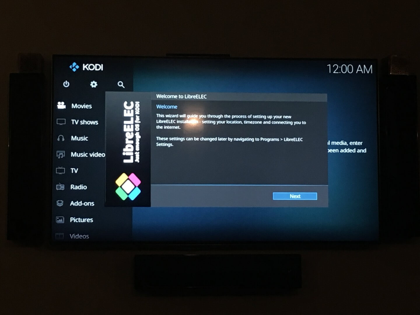

Goodevening you all, i have just recieved a brand new box of pendoo T95z plus. it looks great and works just fine in Android. but in Libreelec the remote is dead and not working at all. please help and advise. Thank you in advance. Greetings
Hi Jallal, I trust you put the original remote.conf from the Android system onto the partition called LIBREELEC on your SD card/USB stick with which you boot into LibreELEC? If not, try that.
Thank you very much, I will try it when I am back home late this evening.
did you copy the remote.conf to \storage\config ?
to get access to that, you need to enable ssh in the initial Libreelec settings on first boot use a keyboard if neccessary
