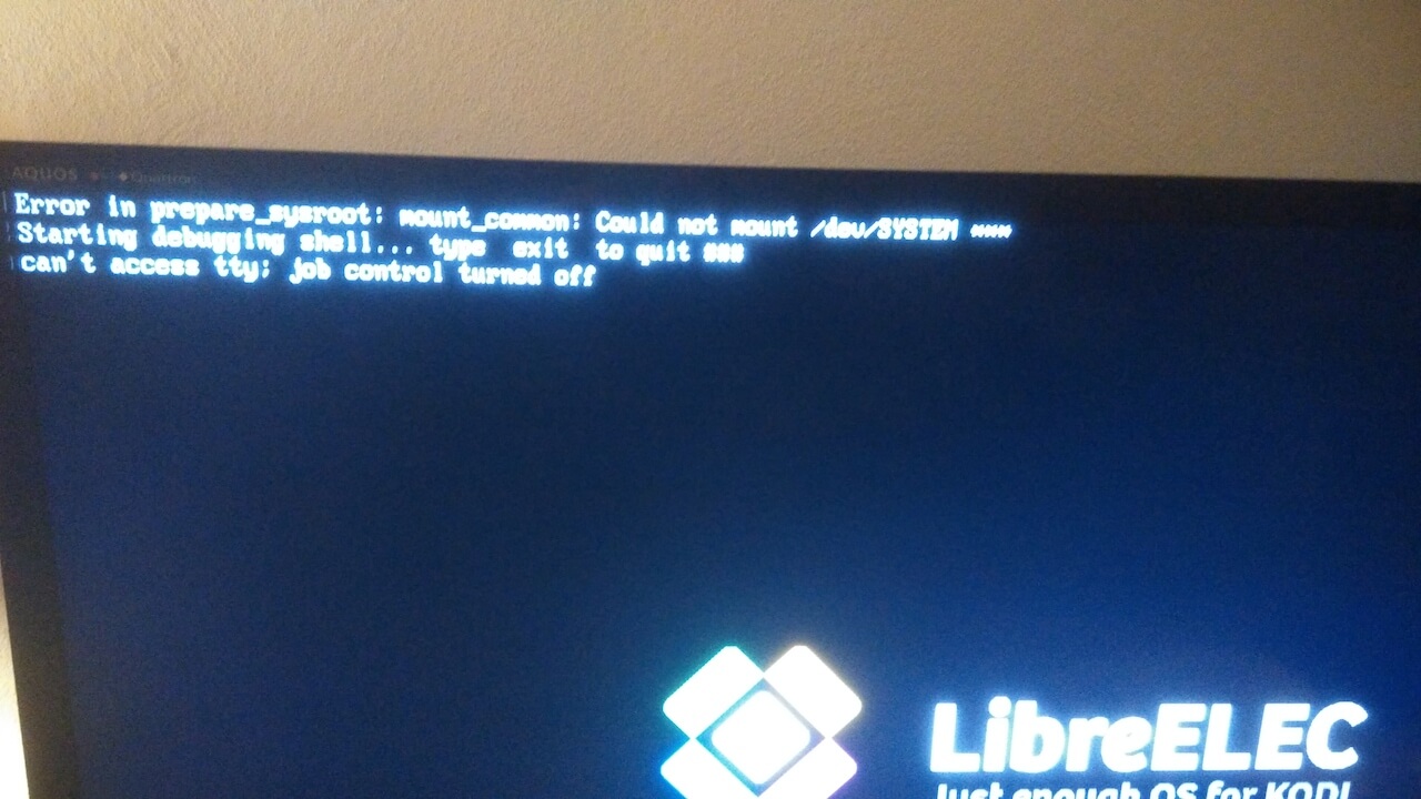

  • I did get this to work by SDcard and am running 8.2rc1 on my MXIII-G 2g/8g.
    Download Libreelec - see post on page 476 page 32 - I used the 7.0.1c link and downloaded this image -
    1- Download "Enable SD card dual boot" zip file, extract & copy files to sdcard/thumb drive (I used sdcard) - OpenELEC-MX3G.arm-DualBootSD.zip
    The OpenELEC-MX3G.arm-DualBootSD.zip Worked in getting this box to Boot Off SD Card. YAY! :)
    The rest is all downhill because what i believe is a Linux File System Used on this box that will pretty much Lock Out LE
    Unless i Flash Android and go again.
    Results after Successful Dual Boot Script zip.
    wilro
    LibreELEC-MX3G.arm-7.0.1c
    Black Screen
    Demetris
    LibreELEC-S802.M8.arm-7.95.3.001
    Black Screen
    Demetris
    LibreELEC-S802.S82.arm-7.0.3
    Booted LE With Error Mount/Dev
    Drieschel
    LibreELEC-S802.M8.arm-7.0.2-2-devel
    forum.libreelec.tv/core/attachment/1852/
    Demetris
    LibreELEC-S802.M8.arm-8.0.RC4
    Corrupt System/Repair Failed after Waiting 2 Minutes repair failed
    forum.libreelec.tv/core/attachment/1852/forum.libreelec.tv/core/attachment/1853/forum.libreelec.tv/core/attachment/1853/forum.libreelec.tv/core/attachment/1854/
  • The OpenELEC-MX3G.arm-DualBootSD.zip Worked in getting this box to Boot Off SD Card. YAY! :)

  • At least you can boot the box now via SD. Half way to a solution.
    I think Demetris should look into that OpenELEC-MX3G.arm-DualBootSD.zip
    That got my Box Booting off SD Card straight away.
  • I think Demetris should look into that OpenELEC-MX3G.arm-DualBootSD.zip
    Here's a couple of things you could try:
    1. Toothpick with DualBootSD and then try SD-booting Demetris (without toothpick since that will overwrite UENV with its own variables)
    2. Toothpick with Demetris but then try USB-booting (that same) Demetris that was used to toothpick (from SD)
  • kostaman PS to last message, you could also try the AlexElec build which I just tried today and it worked - booted from SD ! (on toothpicking with this same image). This is the first image I have ever had boot from SD on this box so I guess there is something in that image regarding the boot-from-SD mechanism that would be useful to put into Dimitris' build here. The version I used on my S802 MXiii was Alexelec MXIII-G V2.3.0 (the latest as of today).
  • LibreELEC-S8X2.arm-8.2.rc1-M8.img.gz seems to have caused my dts pass through to stop working. As soon as I went back to 8.0.2b sound receiver picked up Dolby digital and dts. Let me know if you want any logs or need me to test anything related to dts pass through
    Nice catch i need another one to confirm this though :)
  • you could also try the AlexElec build which I just tried today and it worked
    Thanks Jed
    I tried but Black Screen. I believe this Box has a Non Standard Partition which is locked down. Way over my head but i am sure it is the issue.
    I can Boot SD Card now which was half the battle. I may flash Android on it and try again.
  • Thanks Jed
    I think the boot partition (that the android flash lays down) is important to have the right one. Perhaps after an android flash then a toothpick+normal-SD-boot from alexelec might be possible. The Dimitris build only boots USB (but needs SD toothpick first) for me.
