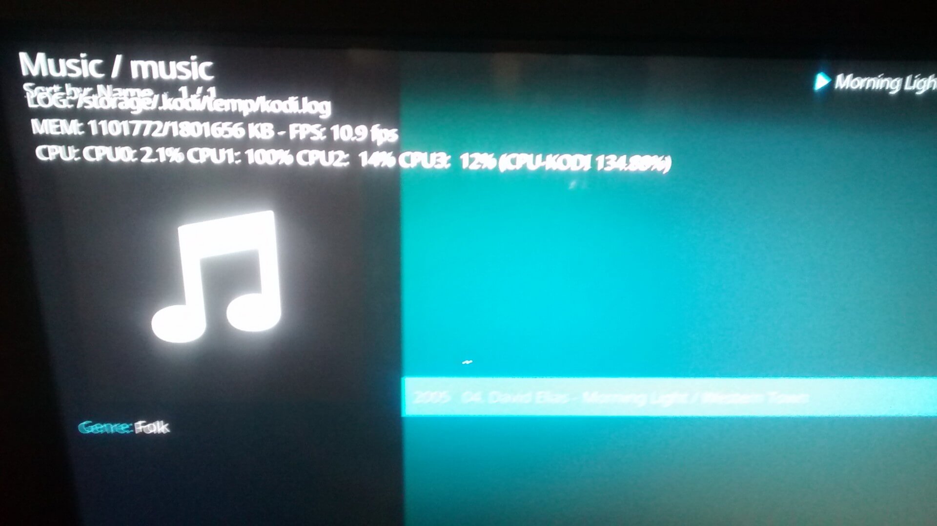

    Hi mime,
    thanks for the pictures.
    We are using the same audio settings! At this point, I don't know what is happening with my boxes.
    I mean, today I copied the file to the internal memory, but the results are the same, when the file is "reproduced", the CPU loads go crazy and the audio is on and off (attached there is the picture, sorry it's fuzzy).
    Am I the only one with this problem :| ?
