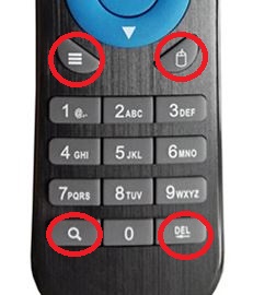

    The three keys mentioned previously, the mouse, the DEL and search, would be nice if I could assign the letters "O" , "Z" and "I"
    During any video playback, "O" gives codec info of source video, "Z" gives playback info like fps, aspect ratio, resolution...and "I" gives info about the video.
    I even tried assigning the letters "O" , "Z" and "I" to numbers 1, 2, and 3 but no luck.

    Here is my remote table:
    # table M8SPRO, type: NEC
    0x0f KEY_NUMERIC_0
    0x52 KEY_NUMERIC_1
    0x50 KEY_NUMERIC_2
    0x10 KEY_NUMERIC_3
    0x56 KEY_NUMERIC_4
    0x54 KEY_NUMERIC_5
    0x14 KEY_NUMERIC_6
    0x4e KEY_NUMERIC_7
    0x4c KEY_NUMERIC_8
    0x0c KEY_NUMERIC_9
    0x1a KEY_ENTER
    0x06 KEY_UP
    0x16 KEY_DOWN
    0x5a KEY_LEFT
    0x1b KEY_RIGHT
    0x45 KEY_MENU
    0x05 KEY_BACK
    0x13 KEY_VOLUMEUP
    0x17 KEY_VOLUMEDOWN
    0x0b KEY_NEXT
    0x08 KEY_PREVIOUS
    0x59 KEY_POWER
    0x0d KEY_HOME # home
    0x12 KEY_O # mouse
    0x51 KEY_Z # DEL
    0x19 KEY_MUTE
    0x22 KEY_I # Search
    I just assume it will work, normally I'll test first but I'm away so... please let me know the result ;)
    (1) Menu button works - pops up context-menu
    (2) Mouse button does nothing (tried F5 and FN)
    (3) Search does nothing
    (4) Del <--- works but only acts like a back key (goes back to previous menu)...even when used while typing text.
    I think I'm happy with the remote and the few non-working keys are no big deal.
