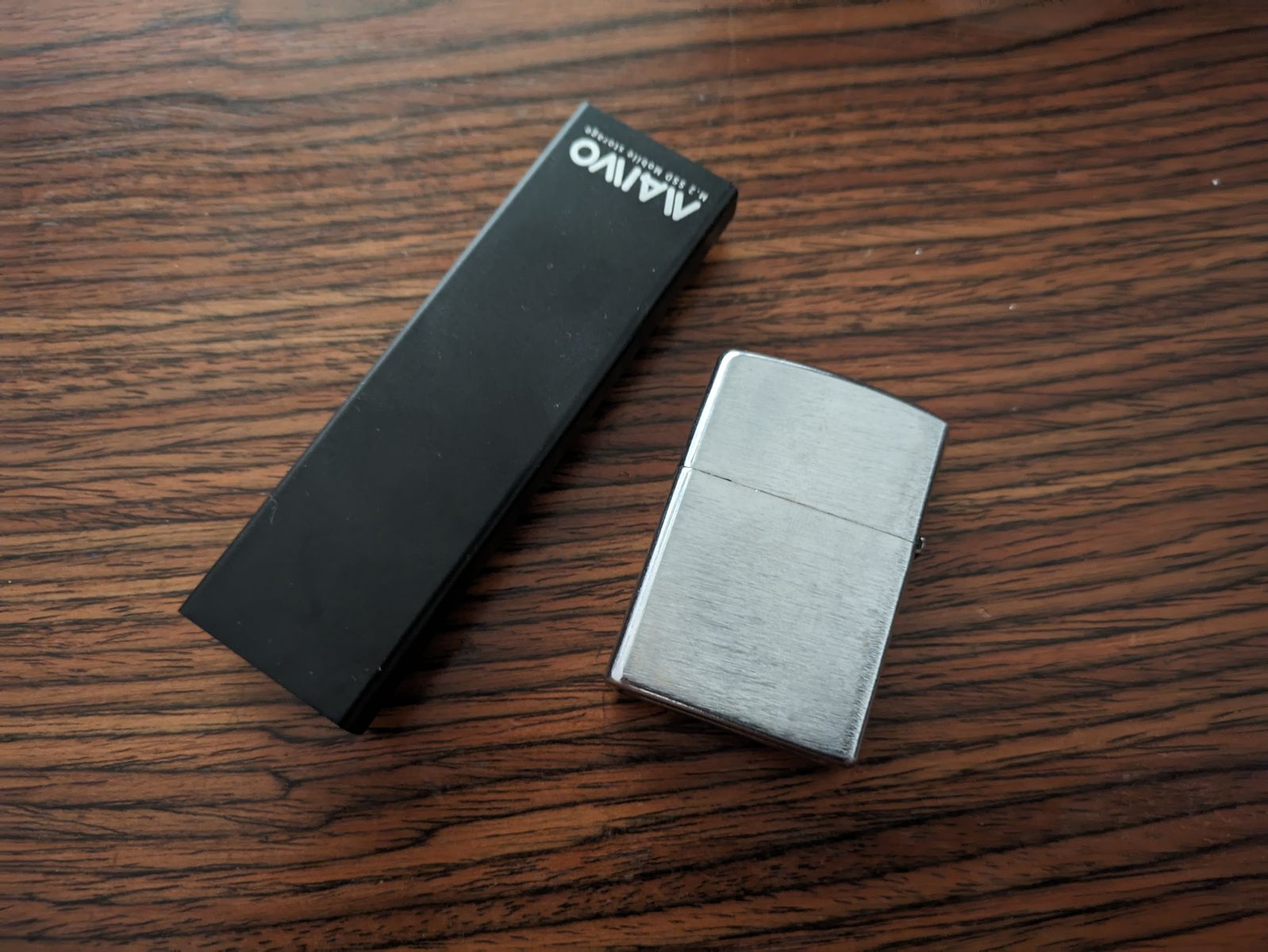

  • You can use an internal SSD with a Raspberry Pi 5. Here's a picture of my test unit. SSDs do increase the price of the Raspberry Pi 5 to where an N100 box is close in overall cost and performance.
    cc29edb8-ae9f-4f6a-beba-473996567f00
    Jeff
