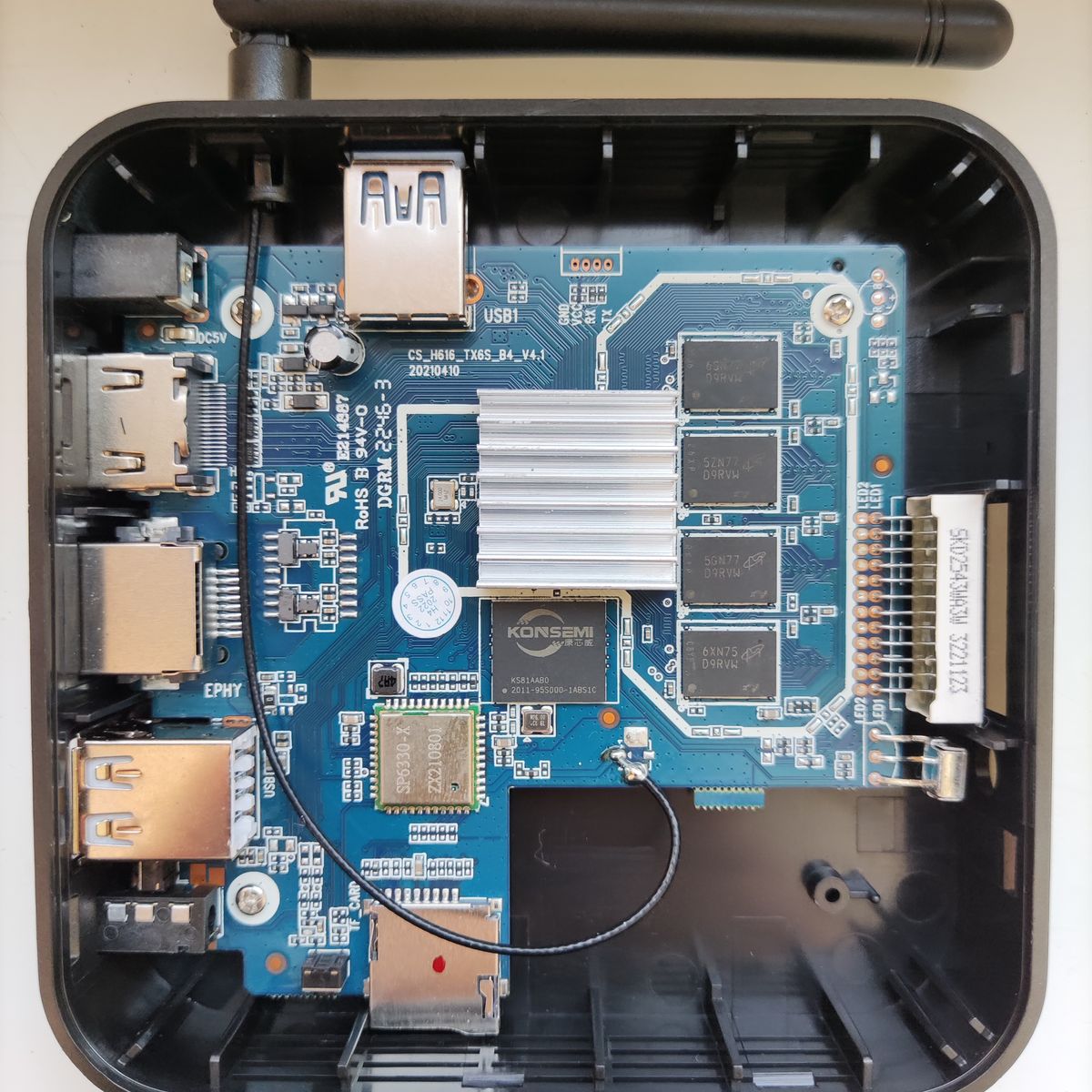

  • Can you confirm that this is really Tanix TX6 with H6 chip and not Tanix TX6s with H616? First is supported, later is not. If in doubt, you can open the box and look under cooler.
  • The dice-roll is always whether the box is a real Tanix box, or a clone of the Tanix box with minor component differences. And the only proof or it using an H6 chip is opening the box up and visually checking. All the main Android box brands are widely cloned, and some even ship with a completely difference SoC inside.

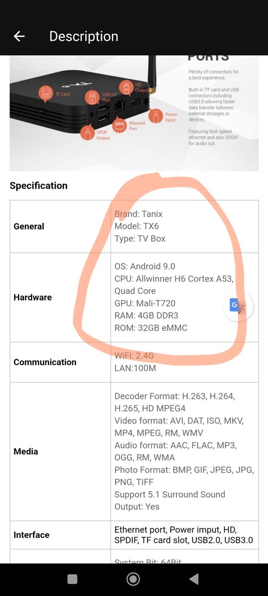

    Hi, I encountered the same problem, bought from China - Geekbuying, Tanix TX6 with Allwinner H6 chip, as it was written in the description and on the box.
    I opened it and inside the surprise it says H616 TX6S!
    The question is can I still hope for LE and for this chipset or do I throw it away?
    Thanks in advance.
    So be careful what you buy and where!!!
