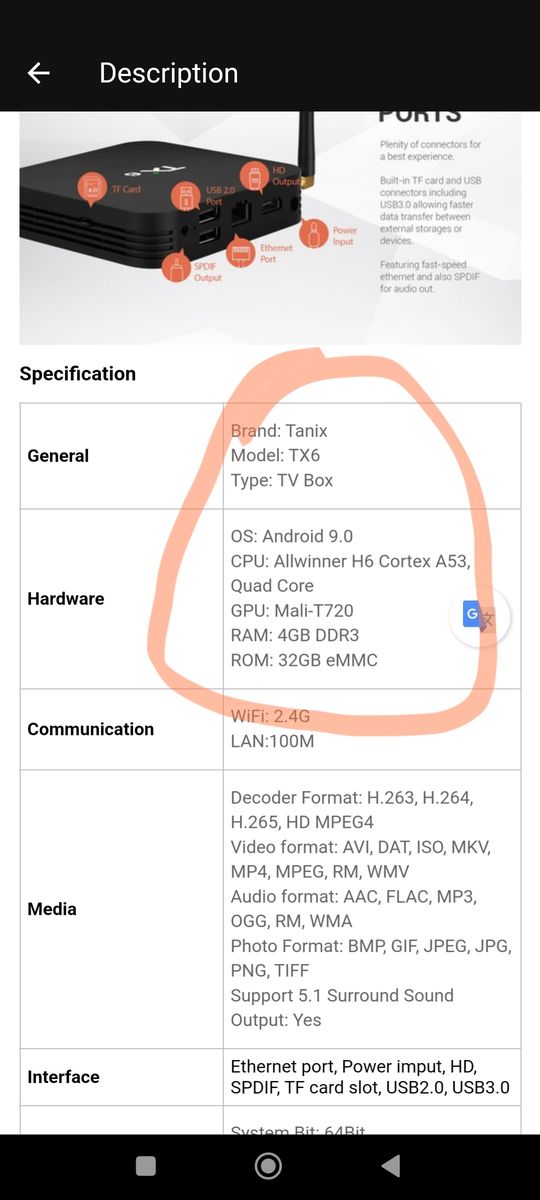

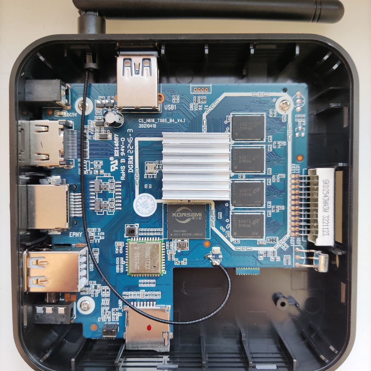

    Hi, I encountered the same problem, bought from China - Geekbuying, Tanix TX6 with Allwinner H6 chip, as it was written in the description and on the box.
    I opened it and inside the surprise it says H616 TX6S!
    The question is can I still hope for LE and for this chipset or do I throw it away?
    Thanks in advance.
    So be careful what you buy and where!!!
