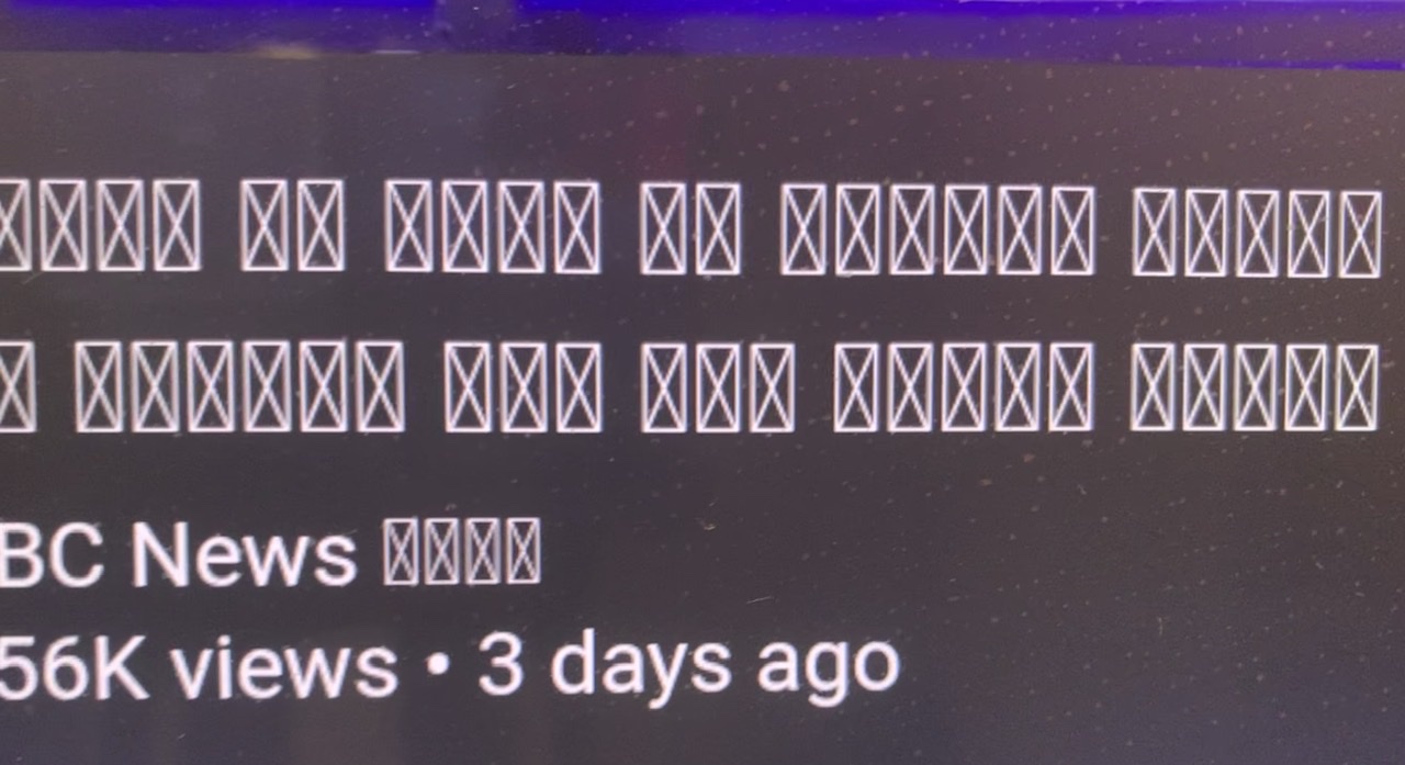

    The problem i have now is the Arabic words shows as boxs

    It doesn't work. I guess Chrome using system fonts and I have no idea how to install arabic fonts to LE !
