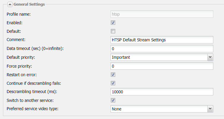

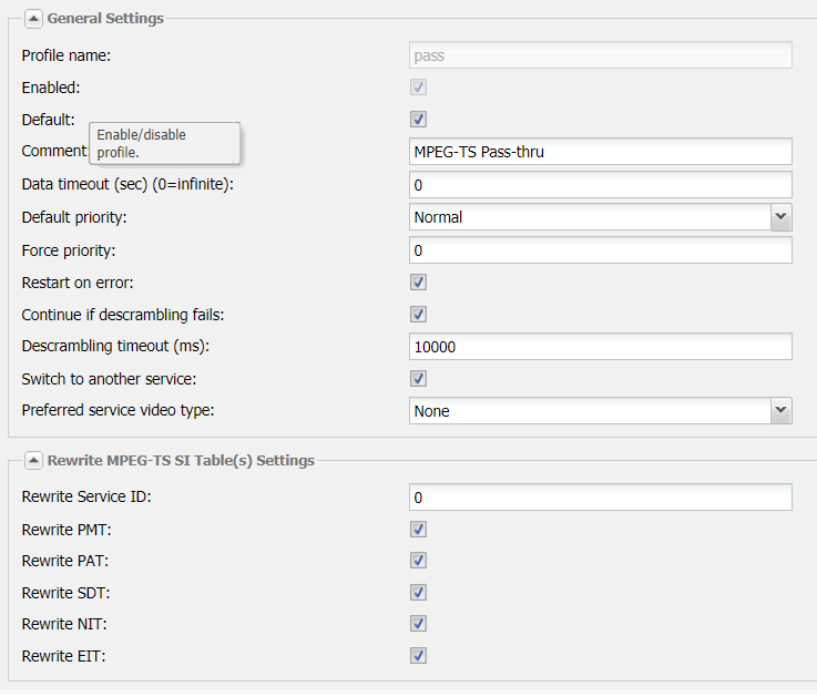

    You should also look into your tvheadend configuration:
    Aren't you using any stream processing that may be changing the framerate ?
    Try to force "pass" profile as default.
    The attached images are my "Pass" and "htsp" profiles current configurations:
    (tweaked a little bit to get best results with handling some video artefacts in reception)
    [configuration / stream / streamprofiles]
    I also use:
    "General / base / packet backlog" : active

  • Also after checking the tvheadend settings i noticed that although the default stream is pass kodi still switches to htsp. In fact with htsp disabled the stream wont even play.
    HTSP uses Pass for streaming..it just adds tvheadend info to the connection for PVR to show additional info...signal etc
    Just leave tvheadend htsp as default and focus to troubleshoot on the frontend..to be sure try to stream from another PC or phone..but it's probably something with RPi4..out of curiosity..do you get the same issues with recordings?
