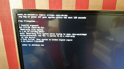

  • balbes150 I started from scratch did a factory reset then put files on SD card then removed aml_autoscript to prevent boot loop as instructed then tried both SD card and USB flash drive attached is the error message my device is T8 AML V3 S812 any ideas?
  • The box use to show the start picture of the Finless Bob Rom for nearly 15 seconds while reading the usb stick. After that libreelec picture is shown with error.
    I understand that LE starts, but gives an error that can not mount the desired partition ?
    What version of Android firmware 4.4 or 5.1 ?
