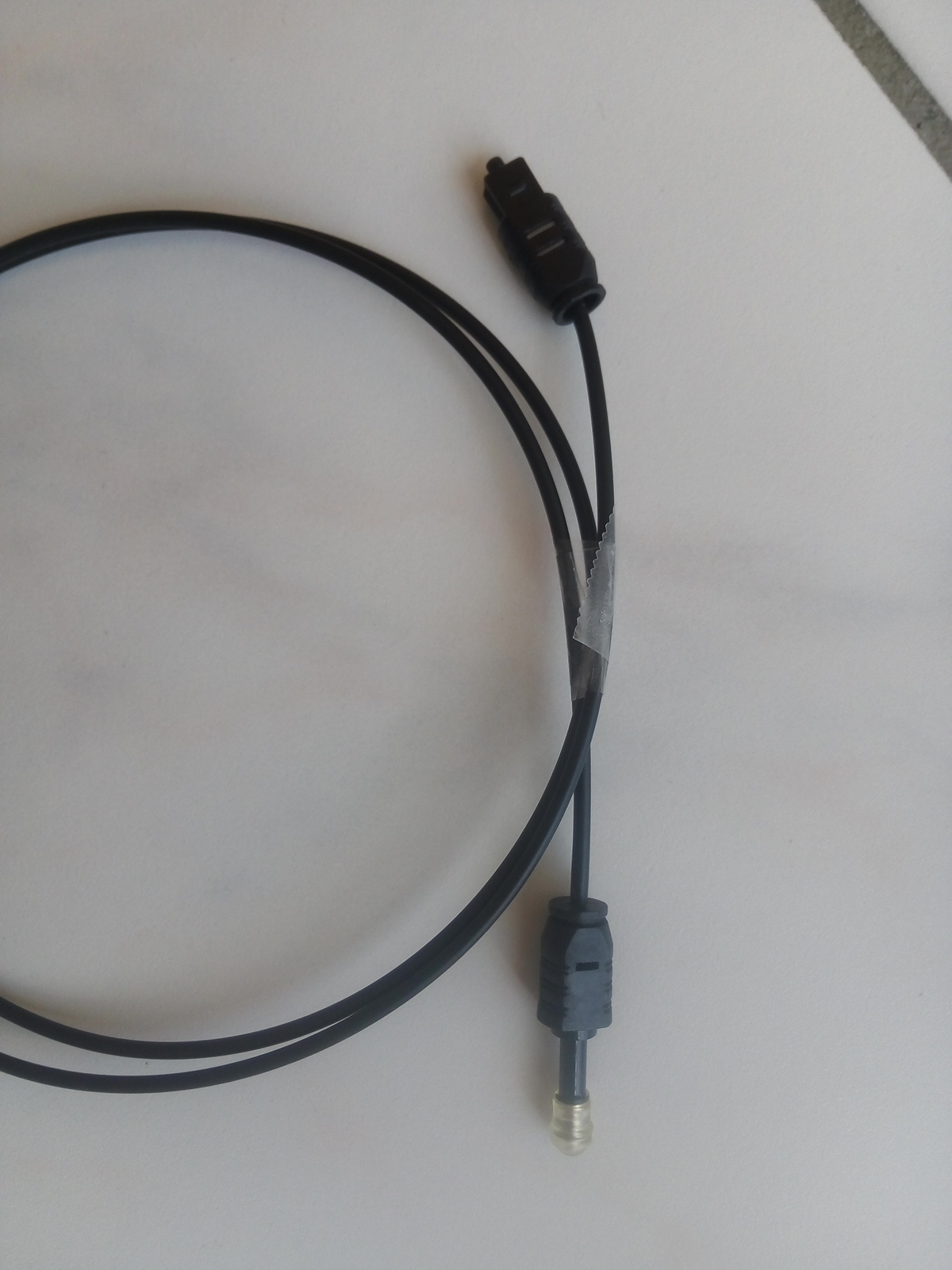

  • EDIT: Btw, the SPDIF output seems different than the regular toslink connector. Is it still an optical out? I know there are different connectors on optical cables. Ones that look like 3.5mm jacks. Is that the one?
    Yes, there's another SPDIF optical output that likes 3.5mm jacks. They are used on cheaper TV box. I tried to attached a photo of mine with this post but couldn't.
  • Yes, there's another SPDIF optical output that likes 3.5mm jacks. They are used on cheaper TV box. I tried to attached a photo of mine with this post but couldn't.
    Thank you! But it works exactly the same, correct? I just need a cable with regular toslink to mini toslink to connect the box to my receiver and that's it?
