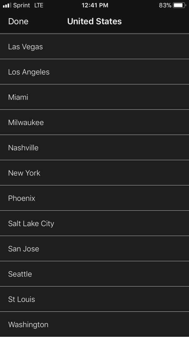

  • Hi Zomboided,
    I use NordVPN via the UserDefinded method mainly because there are so many ovpn files. I'll never use 99.9% of them.
    NordVPN is a good service and their price is quite reasonable, but they're mainly geared towards Windows, Mac, tablet, and phone users via their software.
    If anyone can suggest another good VPN service at around the same price range as NordVPN then I would appreciate it. The downfall of PIA, at least for me, is that they don't have any Atlanta servers. Latency is important to me.

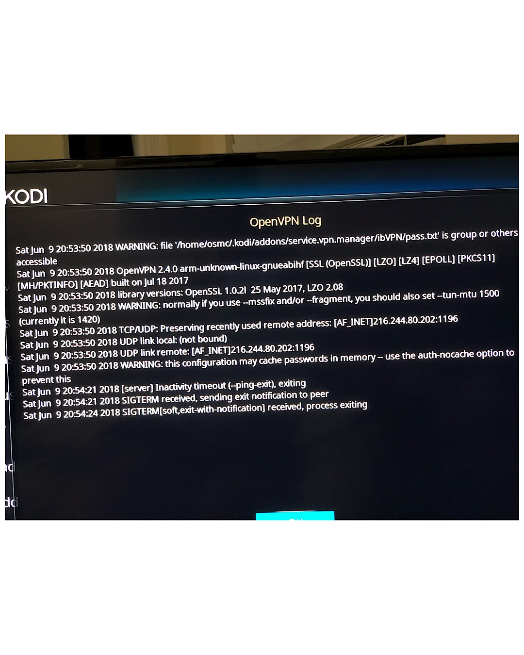

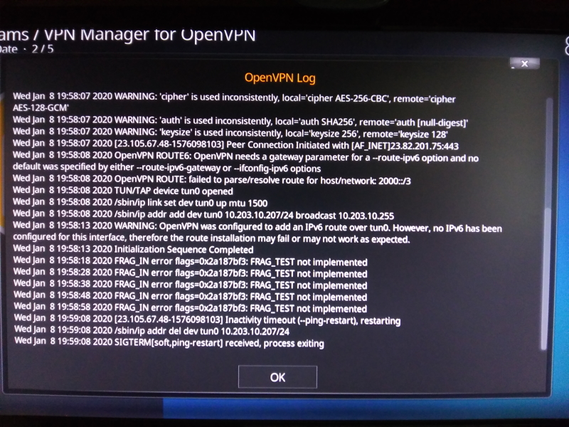

  • Having problems recently with OpenVPN randomly disconnecting and reconnecting. Seems to have gotten worse in the past few days. Can I post the debug log here fos some advice on how to fix? Using IPVanish.
    Im still pretty new but happy to try and follow directions/helpful instructions.

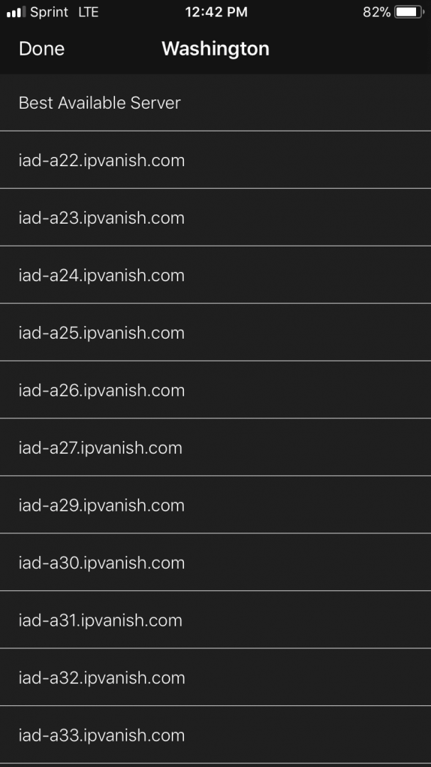

    I use IP Vanish and never have issues related to this add on.
    I have had issues with certain servers being OVERLOADED and i lose internet data even though connection is still validated as connected.
    I go online log in and every time this issue occurs i see online that the server my box is logged into is OVERLOADED.
    I have monitored the servers and i now use one that is generally not loaded most of the time.
    Only 2 servers in my City and both get constantly Overloaded at peak times.
    I change Servers and never have an issue.
    See my screenshot that i sent IP Vanish showing lack of Servers in my city.
    Check and monitor servers first and then see what happens.

  • Sorry for the delayed follow up- new baby at home.
    Sure, trouble shooting link, including log gathering is in the first post.
    Here is the link for my logs - Ubuntu Pastebin
    I have been changing servers to try and circumvent the issue. Please let me know if you see anything I can do to solve this issue beyond moving servers.
    Thank you very much!
  • There's nothing in the log to suggest why it's disconnecting. You could up the tracing by altering the verb setting to 4 or 5 in settings/debug. I'd guess it was a server side problem though given the other comments and the fact that the settings work on other servers ok
