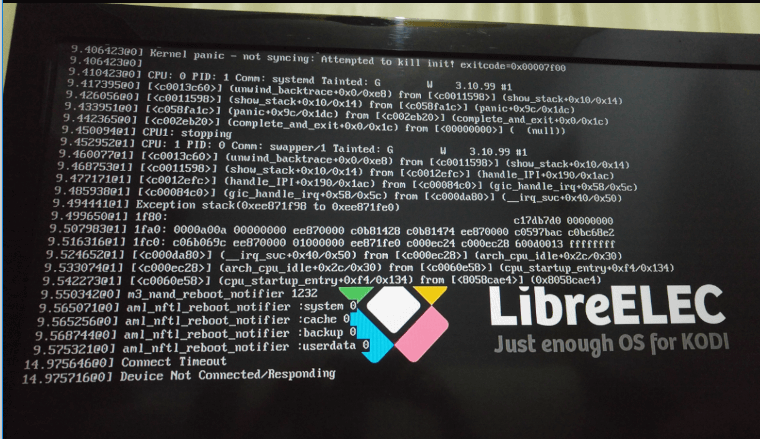

  • I cant seem to get this to work it loads np but as soon as I add my backup it reboots and hangs.Tried it on a gbox mx2 and a knockoff mx2 same thing.Now I noticed on my qbox I get the same results but if I use kodi 17 alpha it loads and works perfect maybe its the version of kodi that's causing the issue not sure

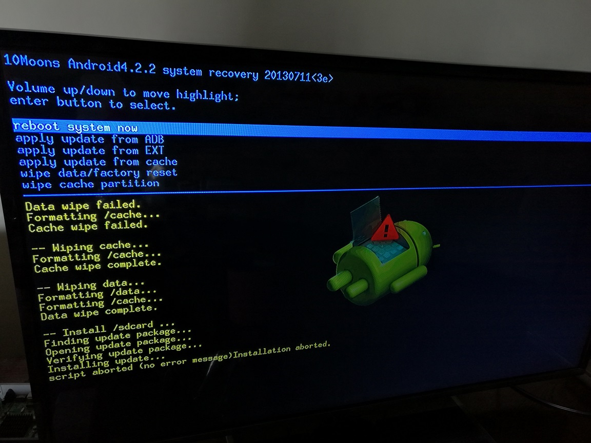

    I have an old Xtreamer Mk4 which is now dead as I tried to install an OE from zip file via built in recovery. It restarted after install process and now it freeze at boot with an OE splash picture...
    It had no any reset button but it's a 8726mx device.
    Is there any way to install this LibreElec build somehow?
    Hope is alive!

    It ran once for me then after rebooting it hung up on the boot screen on my gbox mx2, tried reinstalling an older working version I had on previously and it does the same thing now. Really don't know what to attempt next.

    I can't seem to find any info about your device. Is it really Amlogic 8726-MX device? If so are you sure there is no reset button? It seems to be hidden in AV jack on many devices. Anyway only G18 reference board based devices are supported by this build.
    Any error messages on the screen? Have you tried to do a factory reset or complete reinstall from recovery?

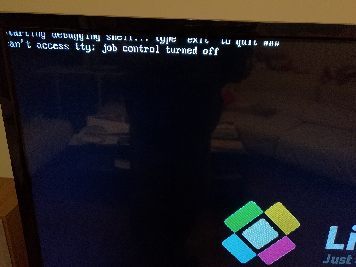

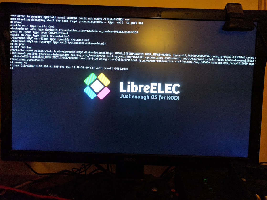

  • Installed this on my mx2 and it gets stuck on the welcome screen at first. If i power the box off and back on i get the matricom logo and a flash of code then a screen that says files corrupted. I've tried doing a clean reinstall and I've tried to downgrade and it won't boot from an SD if it's an older version. Help please
    Edited once, last by MR.E ().
    Can you post a screenshot? Or a copy of what exactly is written on the screen? What files are corrupted? Have you tried to reinstall from recovery?
