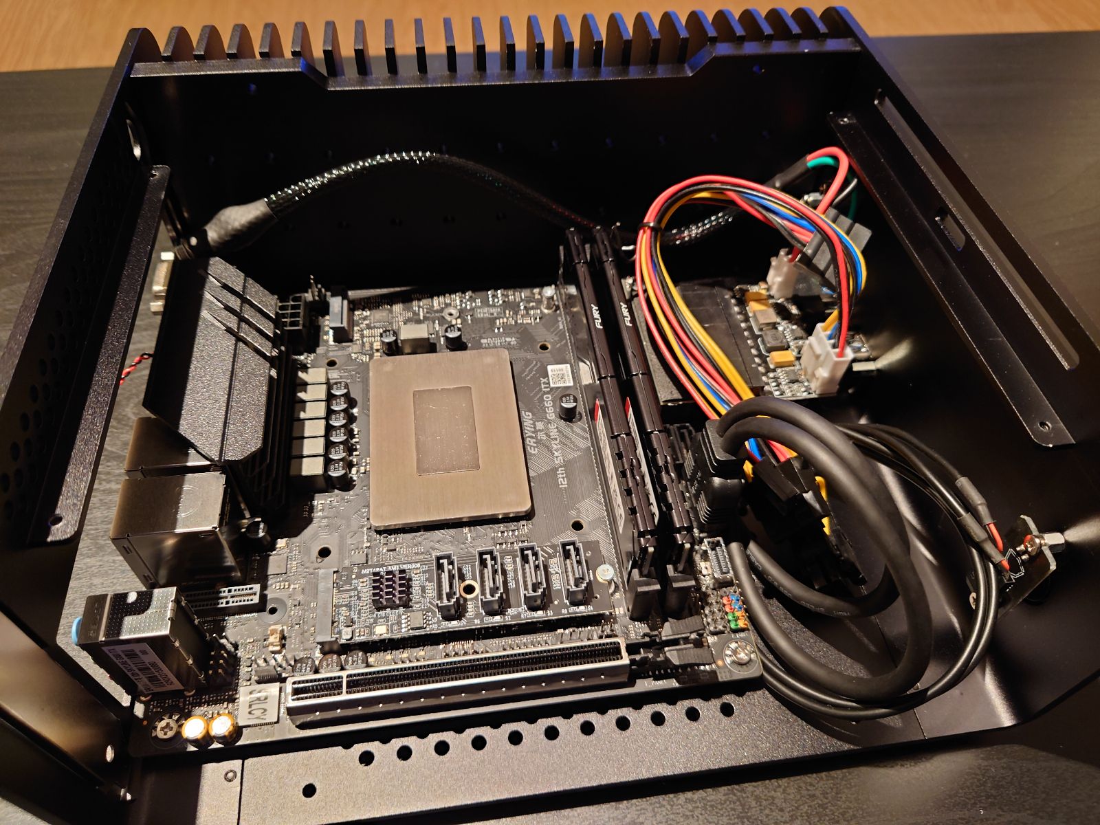

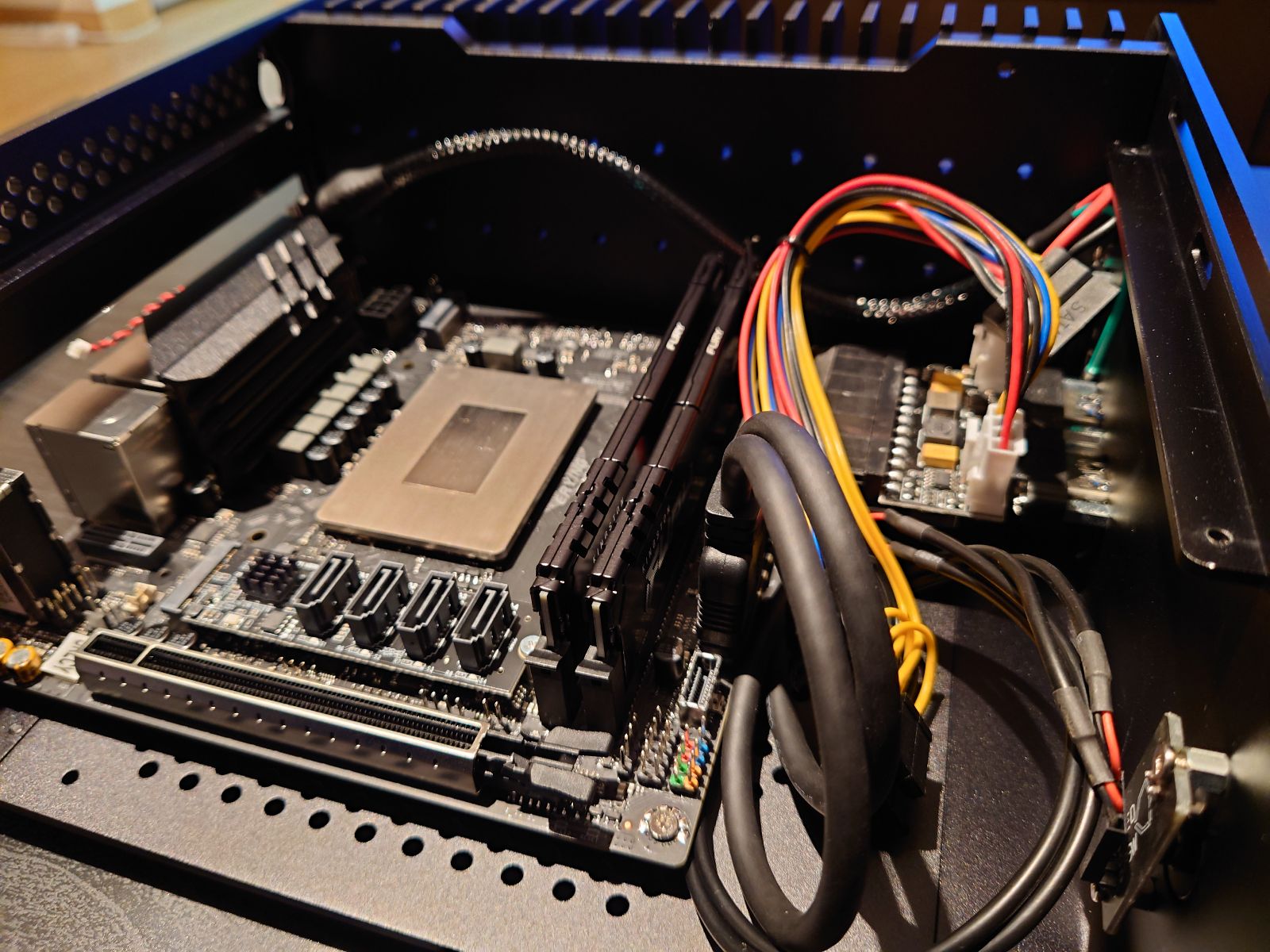

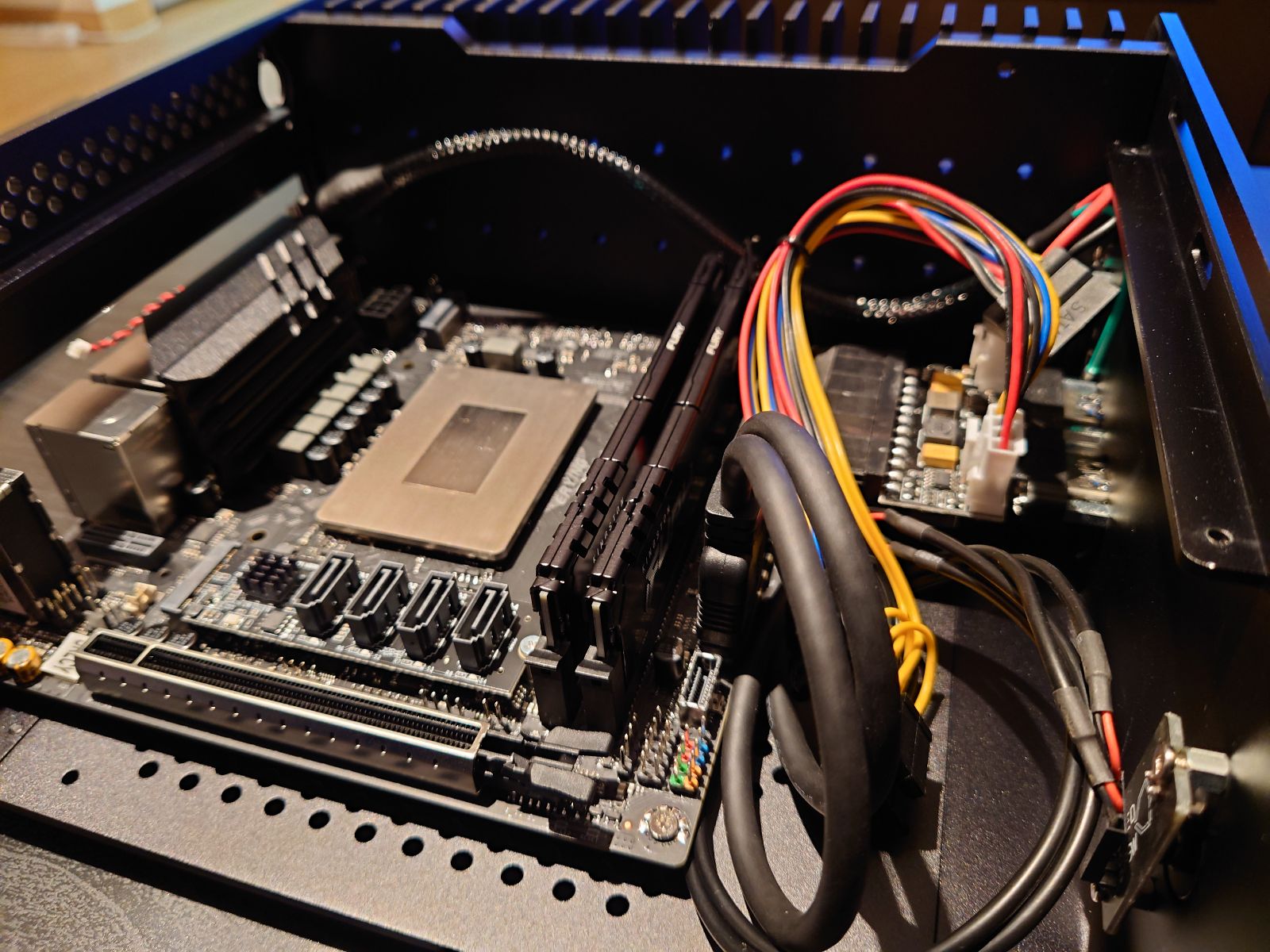

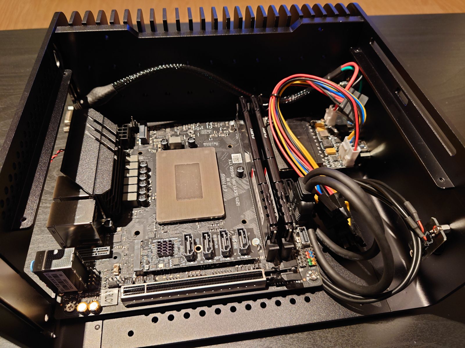

    Just to let you know the current state of the project.
    I've got all the components here:
    Streacom ST-FC8 Alpha (black) - the passive case with optical drive slot
    ERYING Mini-ITX Motherboard i5-12500H - the Mini-ITX board with mobile Intel CPU and Iris XE GPU (i5-12500H)
    Kingston FURY DDR4 3200 MHz 16 GB RAM - dual channel 2x 8 GB memory
    Kingston FURY M.2 500 GB SSD - primary disk for LE
    Panasonic UJ-265 - slot-in SATA Blu-ray writer from "old stock" (Ebay)
    M.2 SATA controller card - 4 port SATA controller expansion card (AliExpress)
    Pico PSU 150 W - 12 VDC ATX power supply (AliExpress)
    and a bunch of small accessories, cables etc. (mostly from AliExpress)
    I've already tried if the basics fit together (I will have to use the bottom M.2 slot for the SSD to avoid the proximity to the heat pipes) and I'm looking forward for the final build process. I have yet to decide what SATA disks I'm going to use for the RAID NAS storage (depending on the remaining space in the case and the cooling performance).
    PCI-E SATA adapter
    I've ordered M.2 SATA controller. It is smaller and there are 3 M.2 slots on the motherboard compared to only 1 PCIe slot, so better to use the M.2 and keep the PCIe free IMHO.
    I've chosen this one with JMicron JMB582:
    I'll try to shorten it from 2280 to 2242 size as the motherboard should fit the shortened version.
