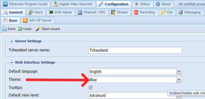

Yeah knew about that one but nothing was happening...had to also change the theme from the users tab...thanks
