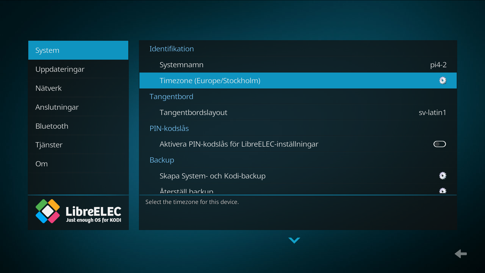

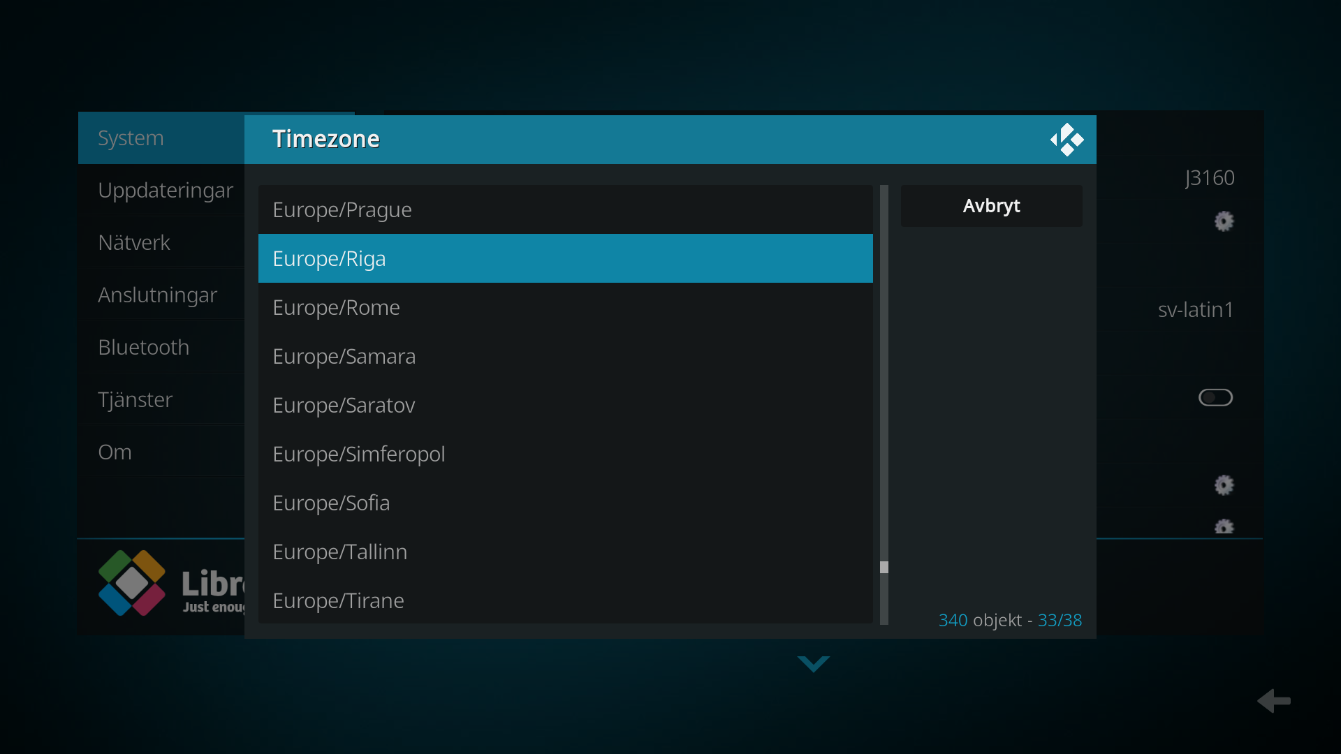

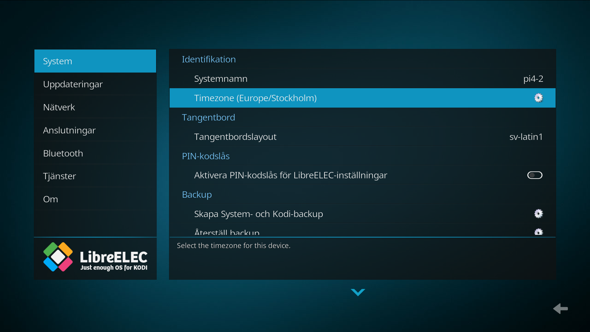

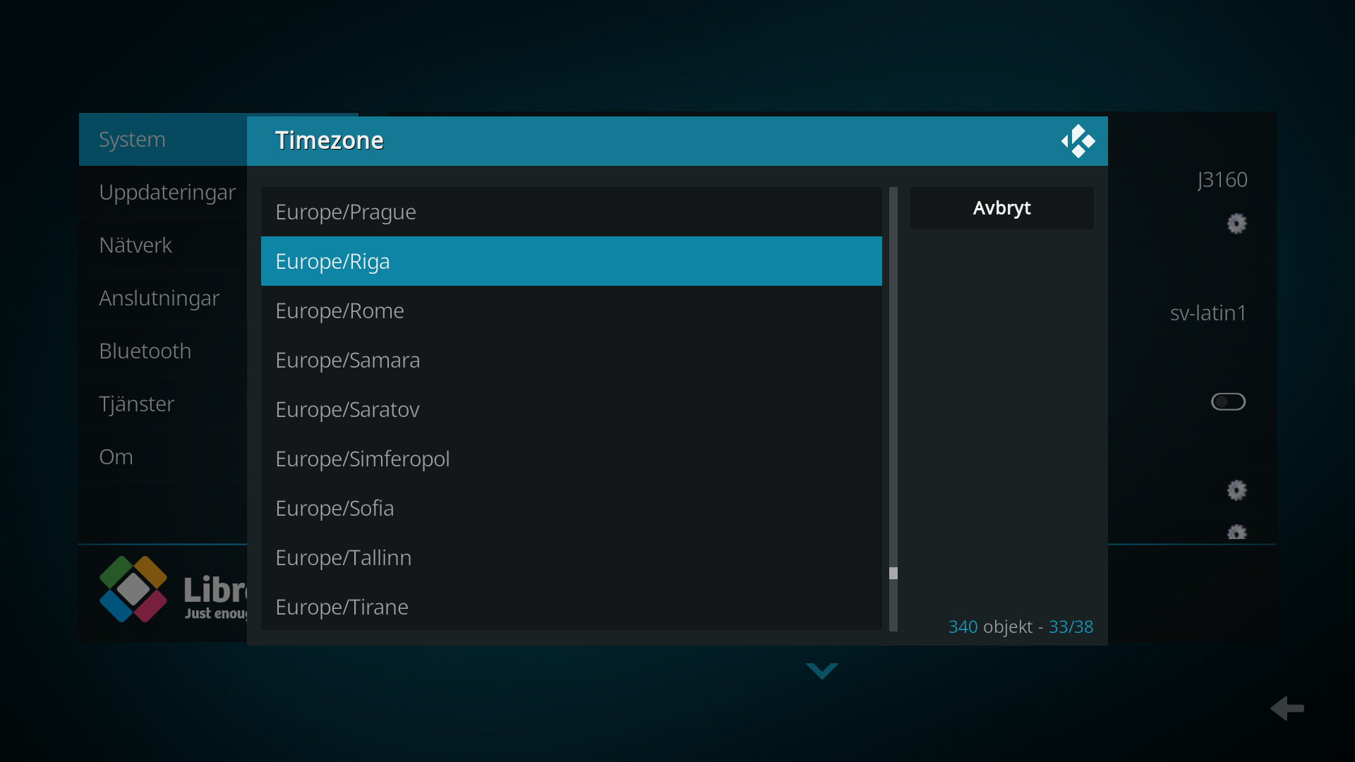

  • Unlikely, for the selection they both do use identical /usr/share/zoneinfo/tzdata.zi
    On my Pi its says Timezone Europe/Stockholm i chosen so its been there earlier, anyway my point is; why is it missing? All other european capitals are present but not Stockholm.
    My Pi's:
    Generic:
  • Set timezone via addon by antonlacon · Pull Request #322 · LibreELEC/service.libreelec.settings
    Initial implementation for selecting the OS's timezone via the settings addon. While it won't cause harm today, it's not intended to be merged…
    github.com
    The timezone list doesn't include deprecated / repeat entries for the same timezone.
    Some timezones is not possible to select anymore. Actually lot of timezones can't be selected because they are not available anymore. Little too much was filtered out.
