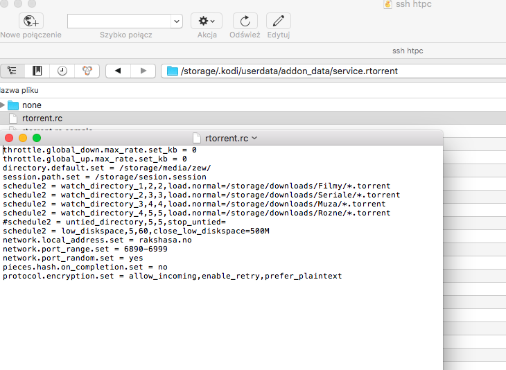

    In my case, rtorrent stores default save path correctly even after restart. But I had to modify rtorrent.rc file for this to work. No json file edit was needed in my case.

  • In my case, rtorrent stores default save path correctly even after restart. But I had to modify rtorrent.rc file for this to work. No json file edit was needed in my case.

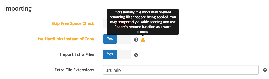

  • januszmirek you use radarr/sonarr? Maybe this is causing you issue (image). If yes, try not rename files to test.
    Or if rtorrent have no especially function that you use, try to migrate for Transmission. I use it with external disk and had no issues about this.
    And if nothing this solve try uninstall and install again torrent client (and maybe LibreELEC itself), because here is working normal!
