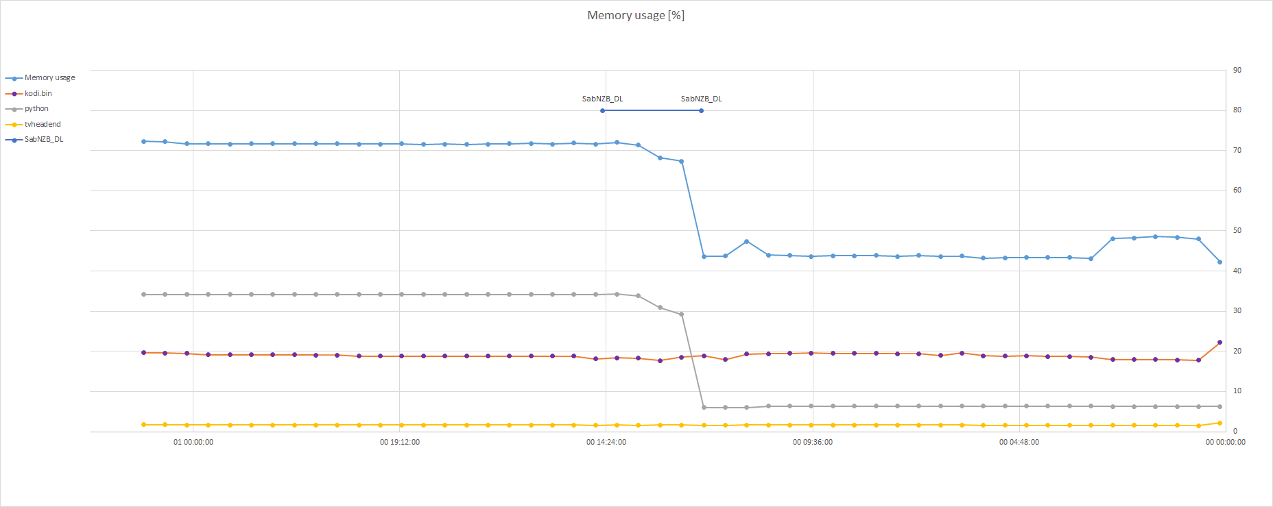

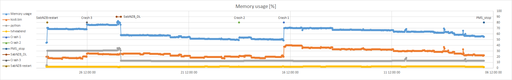

Display MoreI'm using SABnzb 2.3.9 from the Thoradia add-ons on LibreELEC 9.2.6 on a RPi3b.
This works very well except that it appears that SABnzb doesn't release its memory after download/par processing/unpacking.
I'm monitoring memory usage for a high amount of Kodi crashes (still an issue), and now also see that SABnzb doesn't release its memory after use.
The graphs below are made from the output of 'top' sorted by memory usage collected every 30 minutes.
Graph of first occurrence:
(what you see it total memory usage in % in blue, Kodi in orange, Python in grey, and TVH in yellow. Added with some additional time events including the actual download period of SABnzb. And time goes from right t=0 to left. Just look at the most left part for the grey line.)
Graph of second occurrence:
(In above graph again total memory usage in % in blue, Kodi in purple/orange, Python in grey, and TVH in yellow. Added with some additional time events including the actual download period of SABnzb. Look at the grey line which doesn't go down after the download/processing finished.)
Just wonder of other have observed the same...
