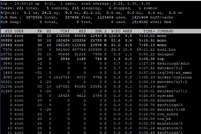

  • I am using Sonarr, Radarr and Jackett from the thoradia repo. For some reason, after a while my CPU usage shoots really high, and ssh top shows that mono is using CPU. Disabling and reenabling sonarr and radarr fixes it, but its really annoying. Any fix?

    You do not provide enough information to assess what is going on.
    Check the logs (System/Logs in the web-ui), report the issue at Radarr/Sonarr, and come back here if the issue is specific to the add-ons.

    Ill try and get some more info, but when i checked the logs, i didnt see anything unusual. Also, the problem does not really seem to be reproducible, happens randomly afaik. Anyway, ill wait and gather more information then report back.
