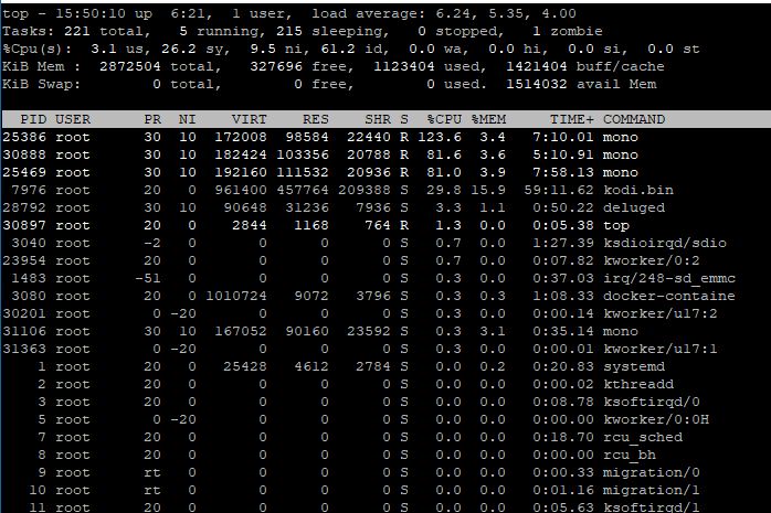

    You do not provide enough information to assess what is going on.
    Check the logs (System/Logs in the web-ui), report the issue at Radarr/Sonarr, and come back here if the issue is specific to the add-on
    Ill try and get some more info, but when i checked the logs, i didnt see anything unusual. Also, the problem does not really seem to be reproducible, happens randomly afaik. Anyway, ill wait and gather more information then report back.
    I am using Sonarr, Radarr and Jackett from the thoradia repo. For some reason, after a while my CPU usage shoots really high, and ssh top shows that mono is using CPU. Disabling and reenabling sonarr and radarr fixes it, but its really annoying. Any fix?
