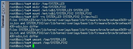

    To fix the wireless issue, the "SYSTEM" file from the LE9 SD card will need to be amended. The LE9 release recognizes the sister BCM43436 as a BCM43430 device, however the binary firmware to drive it is not present. Latest Linux kernels with the BCM43436 firmwares are correctly recognized and load their appropriate drivers, but the legacy LE9 kernel does not. No big deal, the BCM43430 firmware can be simply replaced with the BCM43436 firmware and repackaged.
    This process will require at least getting RaspiOS setup, then unpacking the squashfs "SYSTEM" file, copying the BCM43436 firmware files over the BCM43430 firmware files, and then repacking the squashfs "SYSTEM" file.
    This approach voids the md5 signature, obviously, but corrects the short-coming until a "refresh" of the LE9 is considered, if ever.
    For example:

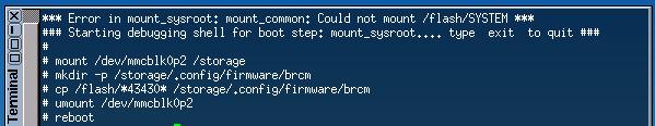

  • The earlier screenshot simply shows the differences on the squashfs based "SYSTEM" file from the original LE9 distribution and after being updated with the BCM43436 firmware when overwriting the BCM43430 .TXT and .BIN files, just what is required should be evident. This approach was meant to yield a more permanent solution when going forward as deploying LE9 on several SD cards for Pi Zero 2s without having to go through the same laborious process as discussed other than copying an updated SYSTEM file, one-and-done.
    The process can in fact be easier, without the added baggage of other components, using the actual LE9 SD media to get the job done. When the "SYSTEM" file is missing, LibreELEC will drop you to a shell prompt, all the necessary firmware preparations can be done from there.
    - Fetch the two BCM43436 files and put them directly on the newly created LE9 SD card including the changes as previously documented and then renaming them to "*43430*". For example at the GitHub repo https://github.com/RPi-Distro/fir…ree/buster/brcm
    - Boot the SD card in the Pi Zero 2 first so that the storage partition can at least be expanded.
    - Next, to get to the LE9 shell prompt, rename the "SYSTEM" file on the SD card to something else and power it up.
    - After the prompt, with the failure in booting message, the storage partition can be mounted, the required directories created, and firmware files copied over.
    - To complete the steps, the renamed "SYSTEM" file should be changed back so that LE9 can startup normally.
    Illustration as reference:
    Thanks for the explanation! That is indeed another way to get the job done. I was going to suggest fetching the files from the RPi Github but I had an already flashed SD with buster on it so I just used that. Your new method would require a Keyboard being attached as well which not everyone has.

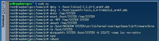

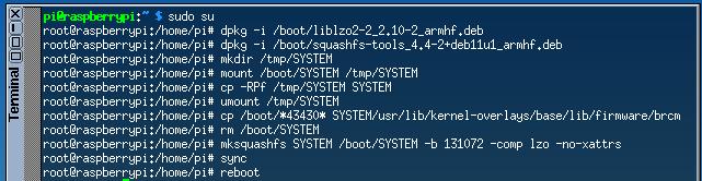

    Knowing that the path forward on LE9 and earlier has come to an end, you may want to keep the changes persistent as you require. Re-doing the steps every time the cards are trashed, getting media built and setup for others, that are less tech savvy, is just a lot of work not needed every time. The patch to the squashfs "SYSTEM" file is much more easily manageable, without any further mistakes to cause unnecessary grief from manual typos. While it is fairly trivial when you work in a full development environment, with all the resources necessary to do the job, the corrections can be completed in just a few steps.
    I will simply have to assume that most people will not have much to work with other than their Pi Zero 2, or any other RPi model for that matter, so the steps needed to take over and above what has been discussed can be reused pretty much to re-cut the "SYSTEM" file.
    Any RPi with the "lite" version of RaspiOS can be used to temporarily make these changes. In addition, two components also need to be pre-fetched to add support to RaspiOS in order to work with squashfs, unless it has already been installed, plus, it does not need to be live on the network for any package updates nor additions, unless you want to.
    - As usual, RaspiOS can be obtained from: https://www.raspberrypi.com/software/operating-systems/ and should be installed as documented.
    - I, in this example, used: https://downloads.raspberrypi.org/raspios_lite_a…-armhf-lite.zip, but the desktop versions will work too, your choice.
    Use the imager tool to create the downloaded RaspiOS SD card. The compression library and squashfs-tools debian packages should also be downloaded and put on the RaspiOS SD card as well after it has been built but before booting so that it will be ready for use.
    - These packages can be obtained from the debian FTP repo and should be saved directly onto the newly created RaspiOS SD card:
    https://ftp.us.debian.org/debian/pool/main/l/lzo2/liblzo2-2_2.10-2_armhf.deb
    https://ftp.us.debian.org/debian/pool/main/s/squashfs-tools/squashfs-tools_4.4-2+deb11u1_armhf.deb
    Also copy from your LE9 SD card the two previously obtained BCM43436 firmware files renamed to "*43430*" and the "SYSTEM" file that you want modified onto the RaspiOS SD card. With all the pieces in place, boot it and login.
    Just a note, all further volatile operations should be done as "root".
    - Use the debian package manager to install the LZO compression library and squashfs-tools directly off the RaspiOS SD card.
    - Create a temporary folder to mount the squashfs "SYSTEM" file and mount it to extract the contents from it.
    - Copy all the read-only squashfs files from the temporary mount onto the storage volume of the RaspiOS SD card.
    - The squashFS "SYSTEM" file can then be unmounted and the wireless firmware files copied over.
    - Delete the original copy of the "SYSTEM" file from the RaspiOS SD card and then rebuild the squashfs "SYSTEM" file back onto the RaspiOS SD card by using the installed "mksquashfs" command.
    Lastly, run "sync" to make sure the RaspiOS SD card is fully written and then reboot. Remove the RaspiOS SD card and copy the updated "SYSTEM" file back onto your LE9 SD card and any further LibreELEC installations that you plan to use on Pi Zero 2s. Don't forget to include the VCOS components which are necessary to boot, as previously discussed.
