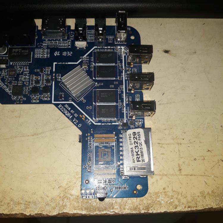

    Obrigado irmão pelo link compartilhado, porém, nenhum dos arquivos foi satisfatório e, literalmente, nenhum funcionou. Neste momento, a placa-mãe que estou usando é uma R329Q84_V2.0 (RK3229) V2.0 e o firmware que estou configurando é este LibreELEC-RK322x.arm-9.2-devel-20200427213549-b7186bc-rk3228b-v88marsII.img. gz
    I think I would need the rc_maps.cfg specific for the infrared sensor of the remote control of this motherboard

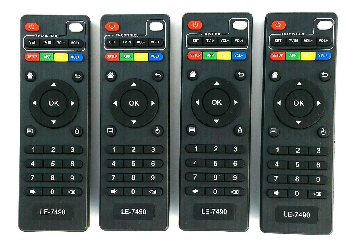

    Este é o controle remoto da placa-mãe
    Esta é a placa-mãe

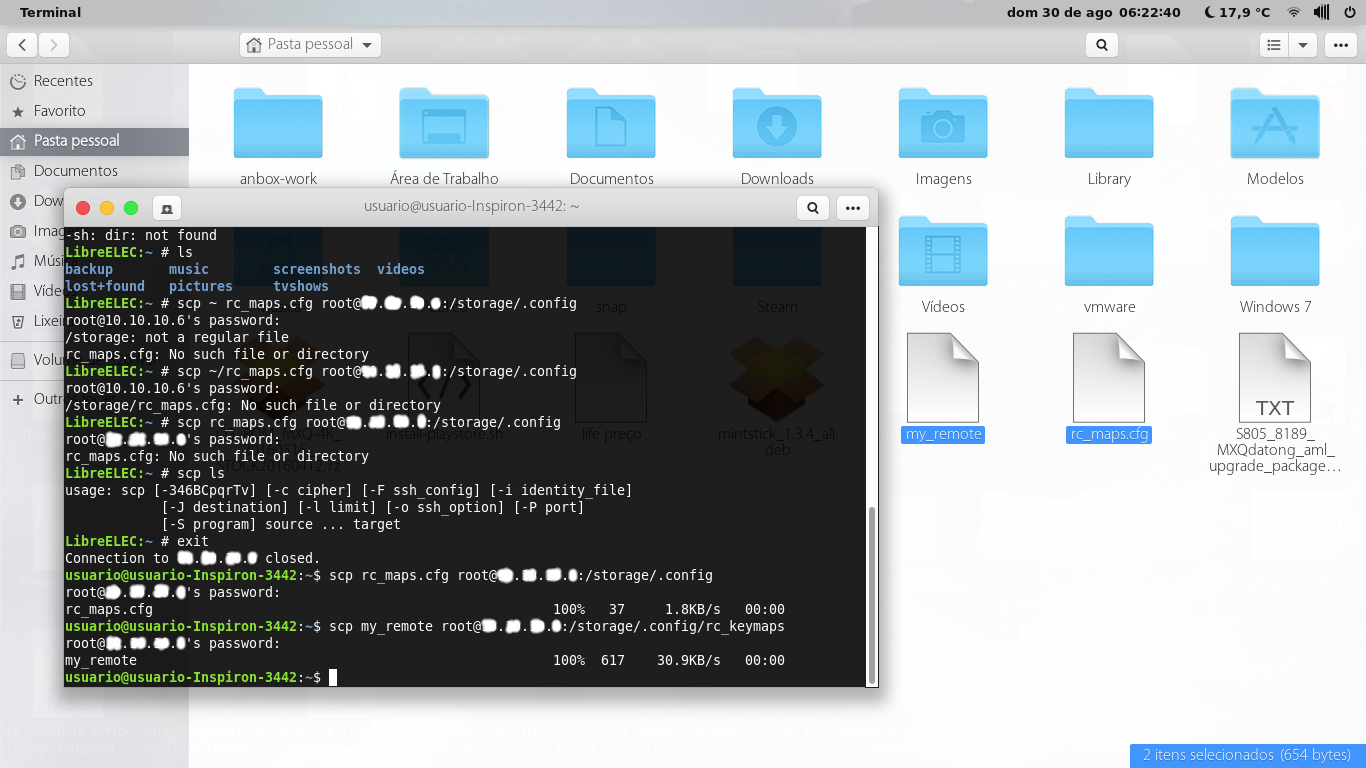

  • copy rc_maps.cfg to /storage/.config, my_remote to /storage/.config/rc_keymaps by ssh then restart box.
    commands:
    scp ~/rc_maps.cfg [email protected]_IP_ADDRESS:/storage/.config
    scp ~/my_remote [email protected]_IP_ADDRESS:/storage/.config/rc_keymaps

  • Congratulations brother, you are AWESOME!!!! That you have many happiness and many blessings in your life, few would do what you have done now, probably this file that you shared does not exist anywhere, it must have been yourself who created it and shared it, I’m really grateful. Thank you.:):D
    IT WORKED PERFECTLY! IT FIT LIKE A GLOVE, BUT AT FIRST I MADE SOME MISTAKES, BUT I GOT IT, THE REMOTE CONTROL IS WORKING PERFECTLY.:thumbup:

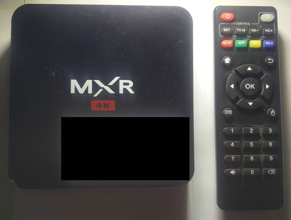

    My box and remote :
    Put rc_maps.cfg in the /storage/.config folder
    and put rem.txt in the /storage/.config/rc_keymaps folder
    MXR4K remote.zip
    reboot, and presto it works,
    My box has one weird thing tho, even when not mapped to any command , when I press the blue VOL+ button my box just instantly completely shuts down :( , not even the normal "kodi shut down spinning circle first" it is just a hard power kill :(
    I wonder if that is just my box or a problem with all these model boxes on libreelec ?
    this is why the normal volume function in my file is mapped to the TV VOL- and TV VOL+ buttons, but you can remap this for your needs afcourse.
