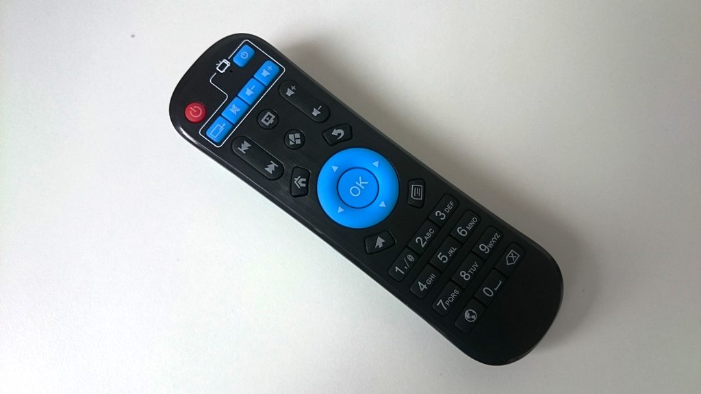

    # This file can be used with Open/LibreElec for the configuration of a factory
    # remote control for: T95x, QBOX, NEXBOX and possible other brands of
    # Smart Android Tv Boxes using the Amlogic U2C remote controller
    # Location of remote.conf: root of the Open/LibreElec startup disk (USB, MC, NaND)
    # factory_code each device has it's unique factory code.
    # pattern: custom_code(16bit) + index_code(16bit)
    # examble: 0xff000001 = 0xff00(custom_code) + 0001(index_code)
    # work_mode
    # 0 : software mode
    # 1 : hardware mode
    # repeat_enable
    # 0 : disable repeat
    # 1 : enable repeat
    # release_delay unit: ms
    # release will report from kernel to user layer after this period
    # of time from press or repeat triggered.
    # debug_enable
    # 0 : debug disable
    # 1 : debug enable
    # SW MODE:
    # bit_count how many bits in each frame
    # tw_leader_act time window for leader active
    # tw_bit0 time window for bit0 time.
    # tw_bit1 time window for bit1 time
    # tw_repeat_leader time window for repeat leader
    # REG:
    # reg_base_gen set value for PREG_IR_DEC_BASE_GEN
    # reg_control set value for PREG_IR_DEC_CONTROL
    # reg_leader_act set value for PREG_IR_DEC_LEADER_ACTIVE
    # reg_leader_idle set value for PREG_IR_DEC_LEADER_IDLE
    # reg_repeat_leader set value for PREG_IR_DEC_REPEAT_IDLE
    # reg_bit0_time set value for PREG_IR_DEC_BIT0_TIME
    # KEY ASSIGNMENT FORMAT:
    # KEY ACTION #COMMENT
    # 0x00 000 #EXAMPLE
    # ORIGINAL:
    # 0x5f 45 #X-STOP (K-SQUARE)
    # ADJUSTED:
    # 0x5f 113 #MUTE (K-SQUARE)
    # Amlogic U2C remote (Blue OK button and TV controls, red power button).
    factory_code = 0xdf000001
    work_mode = 0
    repeat_enable = 1
    repeat_delay = 40
    repeat_period = 39
    release_delay = 121
    debug_enable = 1
    fn_key_scancode = 0x03 #MOUSE
    left_key_scancode = 0x47 #LEFT
    right_key_scancode = 0x07 #RIGHT
    up_key_scancode = 0x1a #UP
    down_key_scancode = 0x48 #DOWN
    ok_key_scancode = 0x06 #OK
    mouse_begin
    0 0x47 #LEFT
    1 0x07 #RIGHT
    2 0x1a #UP
    3 0x48 #DOWN3
    mouse_end
    key_begin
    0x1c 31 #S-POWERMENU (POWER)
    0x01 164 #PLAYPAUSE (TV)
    0x5f 113 #MUTE (KBUTTON)
    0x4b 168 #REWIND (|<<)
    0x4f 208 #FASTFORWARD (>>|)
    0x47 105 #LEFT
    0x07 106 #RIGHT
    0x1a 103 #UP
    0x48 108 #DOWN
    0x06 28 #ENTER (OK)
    0x42 102 #HOME (HOUSE)
    0x0a 14 #BACKSPACE (BACK ARROW)
    0x18 46 #CONTEXTMENU (DOCUMENT)
    0x0c 11 #KEY No.0
    0x54 2 #KEY No.1
    0x16 3 #KEY No.2
    0x15 4 #KEY No.3
    0x50 5 #KEY No.4
    0x12 6 #KEY No.5
    0x11 7 #KEY No.6
    0x4c 8 #KEY No.7
    0x0e 9 #KEY No.8
    0x0d 10 #KEY No.9
    0x10 24 #O-CODEC INFO (BACKSPACE)
    0x41 23 #INFO (GLOBE)
    0x5c 114 #VOLUMEDOWN (VOL-)
    0x5d 115 #VOLUMEUP (VOL+)
    repeat_key_begin
    0x47 105 #LEFT
    0x07 106 #RIGHT
    0x1a 103 #UP
    0x48 108 #DOWN
    0x5d 104 #PAGEUP (VOL+)
    0x5c 109 #PAGEDOWN (VOL-)
    repeat_key_end
    ### 0x52 nn #MOUSE (!!! NEVER !!! use this line, this key is mapped in fn_key_scancode) ###
    # UNASSIGNED
    # 0x5f 45 #X-STOP (THUMBS UP)
    # 0x4d 113 #MUTE
    # 0x09 364 #FAVORITES
    # 0x42 102 #HOME
    # 0x0a 14 #BACK
    # 0x4f 171 #CONFIG
    # 0x09 398 #RED
    # 0x11 399 #GREEN
    # 0x54 400 #YELLOW
    # 0x4f 401 #BLUE
    # 0x5d 104 #PAGEUP
    # 0x5c 109 #PAGEDOWN
    key_end
