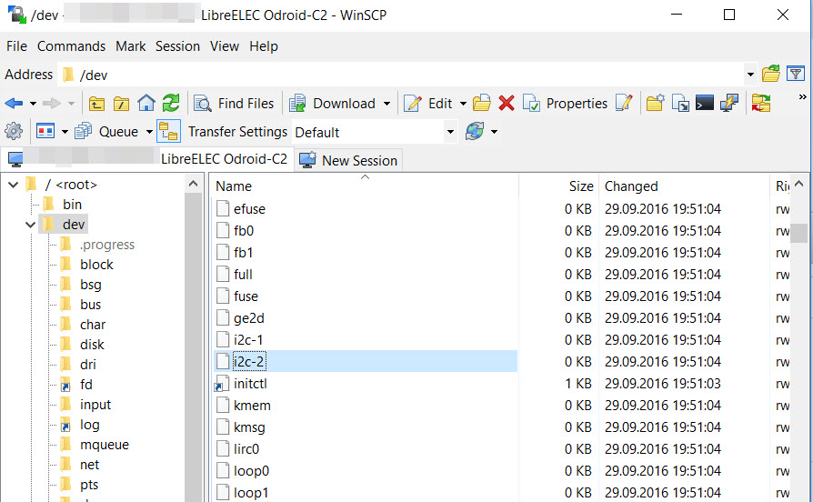

After seeing this thread, I was curious whether my OLED 20x4 would run on LibreELEC (Krypton) v7.90.008 ALPHA for Odroid C2.
Well.. it doesn't... it starts already with the missing i2c-2 address
On wrxtasys 7.0.x / 7.1 builds it works for i2c-2 and i2c-1. Unfortunately it is wired for i2c-2 right now, so I cannot check i2c-1 easily.
Besides the question why i2c-2 is not present?, I still have two more questions:
What would the command to enable /dev/i2c-2 be (i have no hw to test, need some hints for debugging)?
A1. Config folder is now in /storage/.kodi/userdata/addon_data/service.lcdd, accessible via ssh and smb
A2. Settings should be in settings folder
What would the command to enable /dev/i2c-2 be (i have no hw to test, need some hints for debugging)?A1. Config folder is now in /storage/.kodi/userdata/addon_data/service.lcdd, accessible via ssh and smb
good question hmm... I just know that I had to modify in LCDd.conf the line Device=/dev/i2c-1 to Device=/dev/i2c-2
# Device of the serial interface [default: /dev/lcd]
#Device=/dev/i2c-1
Device=/dev/i2c-2
It is visible on my LibreELEC 7.0.x setups on RPi and C2:
And it is not present when using LibreELEC Krypton 008 alpha build. But I am not sure what is responsible that the file appears in the directory /dev/i2c-x :/.

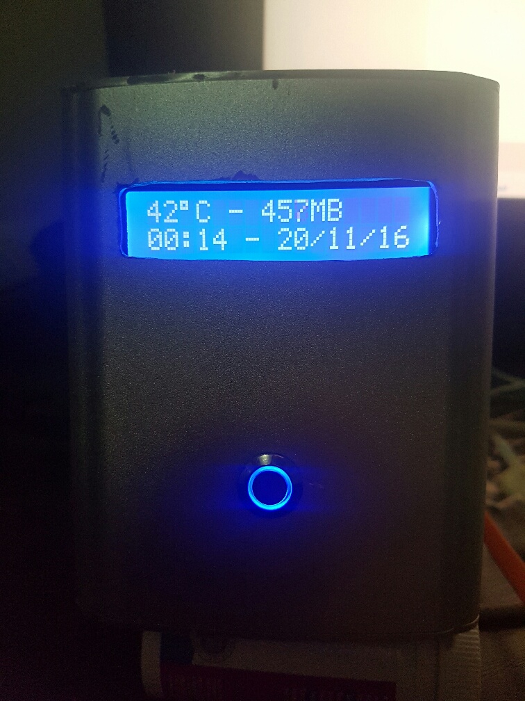

OMG I have my lcd i2c working after using info from here i played for ages and wasn't getting it right was about to give up when wife called me to come eat dinner i had rebooted pi and one last time after making no additional changes which had not work prior to that but i was like wtf...when i returned i had display
my other screen was on a different address so i changed address and rebooted "nothing" played more and "nothing" so i left it to go make coffee when i returned it worked so basically im saying when testing leave for a minute or two before u change more settings as you might have it right an not know it
hope this useless info helps someone LibreELEC (Krypton) v7.90.008

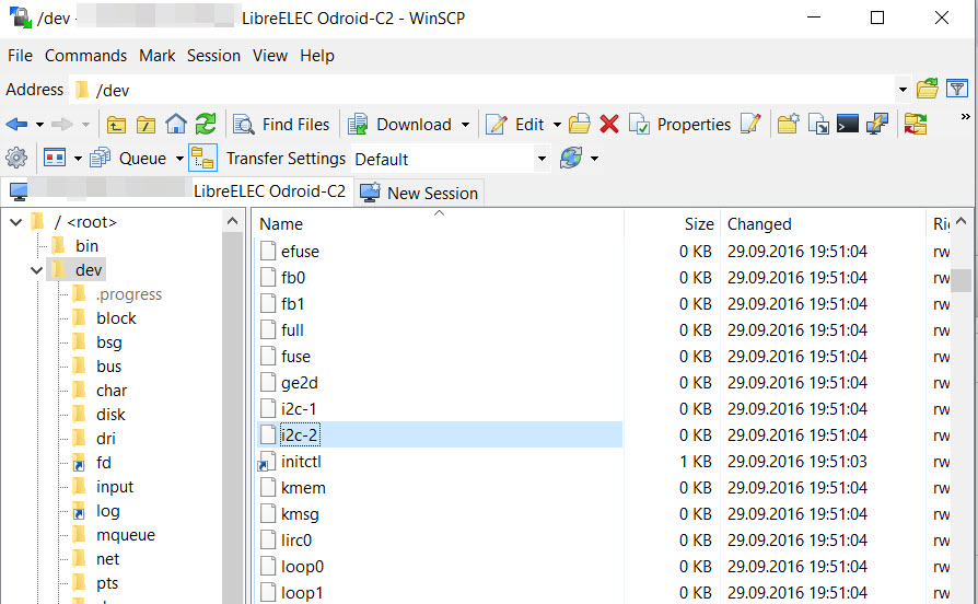

After seeing this thread, I was curious whether my OLED 20x4 would run on LibreELEC (Krypton) v7.90.008 ALPHA for Odroid C2.Well.. it doesn't... it starts already with the missing i2c-2 address
On wrxtasys 7.0.x / 7.1 builds it works for i2c-2 and i2c-1. Unfortunately it is wired for i2c-2 right now, so I cannot check i2c-1 easily.Besides the question why i2c-2 is not present?, I still have two more questions:
- I have to use a custom compiled HD44780 because my controller (SSD1311 is not fully compatible to HD44780). On my Raspberry Pi's and on my Odroid C2 with 7.0.x builds I simply had to put the modified driver and config files (hd44780.so, LCDd.conf) into .config directory and LCD.xml into userdata directory. The display worked then right away after enabling HD44780 displaydriver in LibreELEC Configuration / Services. LCDd.conf contained the path to my custom hd44780.so: "/storage/.config/"
Where do I have to put those files now. LCD.conf in .config seems to be ignored?- There are no settings left in lcdproc (no dimming, no scroll speed, no alternative character choice). Is it coming back, or did you dig those configuration options somewhere else?
will need support added in our linux-amlogic kernel and support in the device tree before you can use it.
