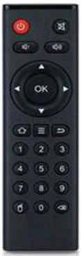

    here is the config for the remote, running ir-keytable -p nec -t on my device:
    However, i searched and found the Tanix TX6 has the same remote as Tanix TX5max (Amlogic S905...).
    The next kernel release will have support for this remote: rc-tanix-tx5max.c\keymaps\rc\media\drivers - kernel/git/torvalds/linux.git - Linux kernel source tree
    Does this mean, a simple entry in the dts with linux,rc-map-name = "rc-tanix-tx5max" under ir and the remote will work ootb?

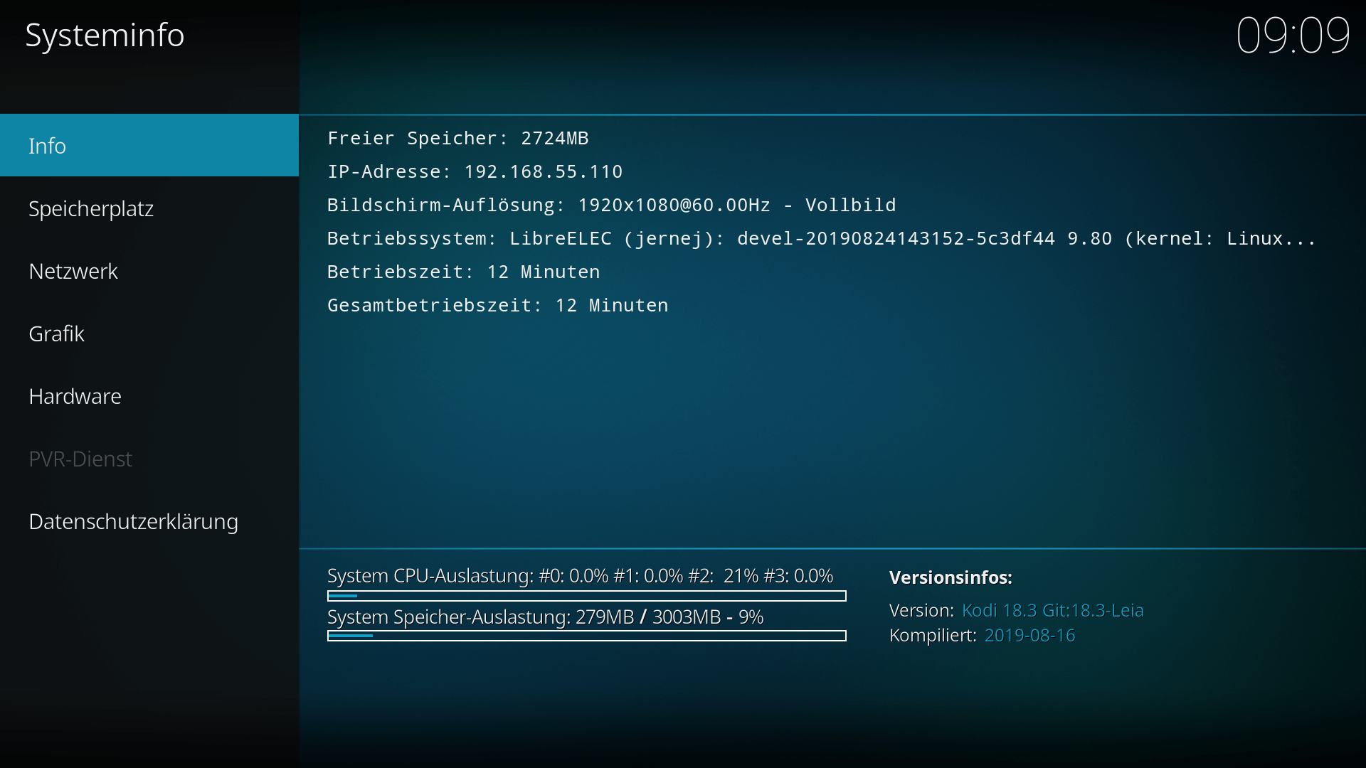

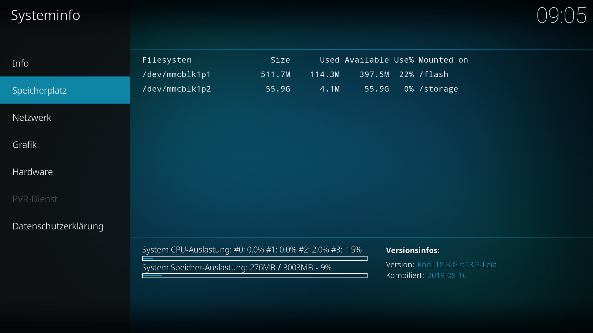

    I can also confirm eMMC is working ... here are two screenshots:
    LibreELEC:~ # dd if=LibreELEC-H6.arm-9.80-devel-20190824143152-5c3df44-tanix-tx6.img of=/dev/mmcblk1 bs=4M
    137+1 records in
    137+1 records out
    575668224 bytes (549.0MB) copied, 2.173960 seconds, 252.5MB/s
    But do not forget to "sync", else you will see this dmesg:
    [   23.342332] SQUASHFS error: zstd decompression error: 14
    [   23.342358] SQUASHFS error: zstd decompression failed, data probably corrupt

    Yes, I realized this, when I had looked into /dev with my image, build from LibreELEC git repo.
    With your image the device shows only these two blocks. So mmcblk0 is the sdcard and mmcblk1 should be the eMMC.

    eMMC - put the image on /dev/mmcblk1, remove sdcard and reboot?
