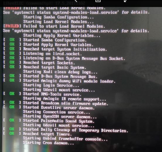

    Test ROM - Tried both USB slots on my M8S, toothpick method, freshly formatted USB stick with the build written with Win32 Disk Imager. Both boots started with the box splash screen then booted into Android recovery screen. The ROM did not load.
    As always with the current rom I get the Load kernel failure error, but Libreelec loads and plays OK - see pic.

    *Error message:
    [FAILED] Failed to start Load Kernel Modules
    See ' systemctl status systemd-modules-load.service' for details

  • You can see which error it is when ssh'ing into the box an run following command: systemctl status systemd-modules-load.service
    On my box this is the result:
    -> systemd-module-load.service:
    Sep 29 10:17:51 LibreELEC systemd[1]: Starting Load Kernel Modules...
    Sep 29 10:17:51 LibreELEC systemd-modules-load[2196]: Failed to find module 'aml
    videodri'
    Sep 29 10:17:51 LibreELEC systemd[1]: systemd-modules-load.service: Main process
    exited, code=exited, status=1/FAILURE
    Sep 29 10:17:51 LibreELEC systemd[1]: Failed to start Load Kernel Modules.
    Sep 29 10:17:51 LibreELEC systemd[1]: systemd-modules-load.service: Unit entered
    failed state.
    Sep 29 10:17:51 LibreELEC systemd[1]: systemd-modules-load.service: Failed with
    result 'exit-code'.
