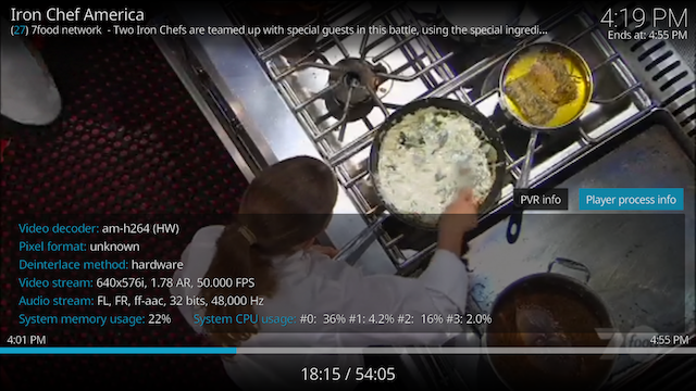

    Tested Rock64 11th Feb Nightly
    Can you see if you get the same result as i do with 7 F00d Network.
    I can't believe the resolution 640 X 576 of this channel. It is what it is.
    I don't whitelist any 576 resolutions.
    Every channel plays back great. SD and HD Except 7 F00d (Censored word) Network.
    Black bars either side with squashed picture.
    I whitelisted 576 and got the usual stretched crap picture. Not a solution.

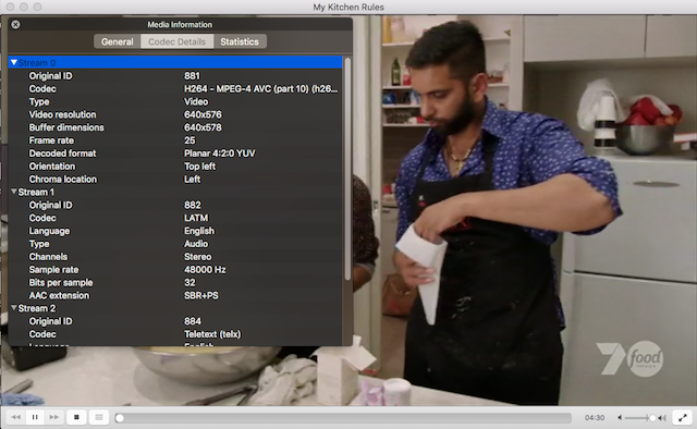

    Second Picture is VLC on mac Codec info
  • Same here on various platforms. it's not unique to Rockchip.
    Go into On Screen > Video Settings when viewing that Channel and select > View Mode > Stretch 16:9
    Kodi will remember it.
